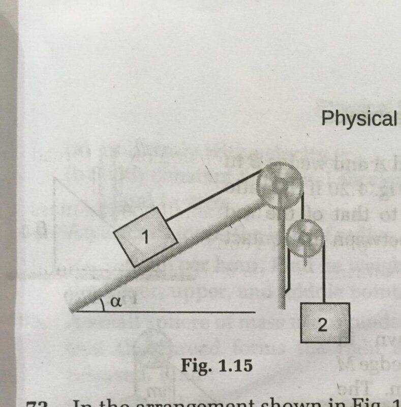

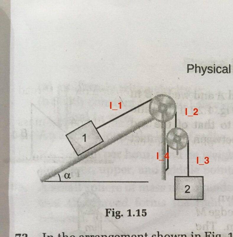

(I.E. Irodov problem 1.72) Dynamics problem involving a pulley
28 replies · 5K views · last reply
Adesh
735
191
Find the acceleration of the body 2 in the arrangement shown in the figure, if it mass is ##n## times as great as the mass of the body 2 and the angle of inclination plane forms with horizontal is equal to ##\alpha##. The mass of the pulleys and the threads, as well as the friction are assumed to be negligible. Look into possible cases.
Newton's 2nd Law ##\Sigma F = ma##
Fig. 1.15: block 1 on an incline at angle α, connected by a string over a pulley at the top to a hanging block 2 with a second pulley below the first.
First thing that I notice is that the other part of string (to which body 2 is connected) is fixed. Therefore, I concluded that the body 2 is stationary with respect to the pulley 2 (let's agree that pulley to which body 1 is connected is pulley 1 and in same way pulley 2 is defined).
Forces on body 1:
##m_1 g \sin \alpha##
##T_1##
Let the acceleration of body 1 be ##a##, then we have ## T_1 - m_1 g \sin\alpha = m_1 a##.
The string which is going down from pulley 1 will have same acceleration as the body 1, so we can conclude that the acceleration of the body 2 will also be ##a##.
But I'm unable to progress from here, please guide me.
Thanks.

The length of string running over pulley 2 is constant. If pulley 2 moves vertically then the portion on the left of it changes, so the portion on the right changes. That changes the distance between it and mass 2.

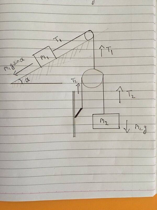

Here is my Free Body Diagram for the problem:
Hand-drawn free-body diagram of two masses on a pulley system: m1 on an incline at angle alpha, tension T1 along the incline and m1 g sin alpha down the slope; a movable pulley hangs from T1 and T2 with mass m2 below, weight m2 g downward, and a vertical support with tension T2 upward.
For body 1 we have
T_1- m_1 g \sin \alpha= m_1 a$$
For body 2 and with respect to pulley 2 we have :
T_2 - m_2 g = m_2 a’$$
(##a’## is the acceleration of body 2 with respect to pulley 2).
What should I do next?

This is a common error. Mass 2 is not attached to cable 1, so "knows" nothing about it. It is subject to two forces: the tension in cable 2 and gravity. This is one reason students are encouraged to draw free body diagrams for each separate rigid body.
For the relationship between the tensions, draw the free body diagram for pulley 2. Remember, it has no mass, so what does its ΣF=ma equation tell you?
For the kinematic relationship, haven't we been through this before?
Assign variables to the various straight lengths of cable. Write the equations representing how these relate to the total lengths of the cables of which they are part, and for how they relate to the vertical height of mass 2 and distance down the slope of mass 1.
You can then differentiate twice to obtain equations relating accelerations.

For pulley 2 we have
T_1 - 2 T_2 = m a$$
T_1 = 2T_2$$.
The acceleration of the cables connected to pulley will be equal (due to that 2nd derivative method). So, finally we have from lab’s reference frame
T_1 - m_1g \sin \alpha= m_1 a $$
$$T_2 - m_2 g= m_2 a’$$
Using the relationship between the two tensions, we have
2T_2 - m_1g \sin \alpha = m_1 a$$
$$T_2 -m_2 g = m_2 a’$$
Am I correct this far? What should I do next?

Sir, I don't know but I'm unable to make equations of length of strings this time, nevertheless let me try
Physics diagram of a block labelled 1 on a smooth incline at angle alpha, connected by a string over a pulley at the top to a movable pulley hanging below, with block 2 suspended from it; string segments labelled l_1, l_2, l_3 and l_4 in red.
##l_1 + l_2 +l_3 +l_4 = c##. Differentiating this expression twice w.r.t time,
\frac{d^2}{dt^2} l_1 + 0 + \frac{d^2}{dt^2} l_3 + 0 = 0$$
If I take pulley 1 to be origin then ##\frac{d^2}{dt^2} l_3## can't be called the acceleration of mass 2, because at any time the position of mass 2 is ##l_2 (t) + l_3(t)## and if we use this fact we would have
\frac{d^2}{dt^2} l_1 + \frac{d^2}{dt^2} (l_2 +l_3) + 0 = 0$$
a = -a'$$.
And now, using this equation we have
T_2 = \frac{-ma' + m_1g \sin \alpha}{2}$$
T_2 = m_2 a' + m_2 g$$
-m_1 a' + m_1 g \sin \alpha = 2m_2 a' + 2m_2 g $$
a' = \frac{(2n-\sin\alpha)g}{2n+1}$$
(In the last equation I used the given condition that ##m_2= m_1 n##)
There are two threads. Each is of fixed length.
l2 and l4 vary in length.
If we consider origin as the pulley 1 and focus on first cable, we have
l_1 + l_2 = c$$
$$\frac{d^2}{dt^2} l_1 + \frac{d^2}{dt^2} l_2 = 0$$
$$a_{mass~1} = -a_{pulley 1}$$
Now, coming to frame of reference of pulley 2, we have
l_3 + l_4 = c$$
a_{mass ~2}= -\frac{d^2}{dt^2} l_4 $$
I don’t know what to call ##\frac{d^2}{dt^2} l_4 ##.
l_1 + l_2 = c$$
l_3 + l_4 = c$$
There is also a simple relationship between l2 and l4.
Careful with signs. Bear in mind that e.g. ##\frac{d^2}{dt^2} l_1## is the 'acceleration' of the length l1. Whether that is the same as the acceleration of mass 1 depends on which way you are defining as positive for mass 1's acceleration. Increasing l1 corresponds to mass 1 descending the slope.
Sorry! But I cannot see it. Can you please tell me what’s the relation between them?
Since the distance between the anchoring point of L4 to the wall and the center of pulley 1 is constant, so is the addition of L4 and L2.
It is a simple set up to reproduce, using a fine string and two paperclips, they work just like pulleys.
If you could experiment with it, you could easily see those relations.
Oh okay! that means
$$\frac{d^2}{dt^2} l_4 = - \frac{d^2}{dt^2} l_2$$
Right?
I am not sure (too much math for me). :smile:
As its end is anchored down, L4 is not moving or accelerating, it is just becoming shorter or longer.
All right, for cable 1 we have
\begin{aligned}
&\frac{d^2}{dt^2} l_1 (t) = - \frac{d^2}{dt^2} l_2 (t) \\
&a = \frac{d^2}{dt^2} l_2
\end{aligned}
For cable 2 we have
\begin{aligned}
&\frac{d^2}{dt^2} l_3 (t) = - \frac{d^2}{dt^2} l_4 (t) \\
& a' = - \frac{d^2}{dt^2} l_4 (t)
\end{aligned}
We must remember that ##a'## here is the acceleration of mass 2 w.r.t pulley 2.
From post #19 we know that ##\frac{d^2}{dt^2} l_4 = - \frac{d^2}{dt^2} l_2##, now using this equation to obtain ##a =a'##
Dynamical equations are :
\begin{aligned}
T_1 = 2T_2 \\
2T_2 - m_1 g \sin \alpha = m_1 a \\
T_2 - m_2g = m_2 (a+ a')
\end{aligned}
Solving this system of equations by using ##a=a'## will give us
a = \frac{(2n - \sin \alpha)}{4n+1} g$$
Therefore, the net acceleration of mass 2 is ##a+a' = 2a= 2\frac{(2n - \sin \alpha)}{4n+1}##. Yes, we are done.
I want to clear up few things:
1. I'm totally unaware of how to keep the track of signs. For pulley 1, I took the downslope as negative and upslope as positive, and similarly for pulley 2, going down is negative and up is positive. But if we adhere to this system of signs, why we have ##\frac{d^2}{dt^2} l_1(t) =- a## but ##\frac{d^2}{dt^2} l_3(t) = a'##? In both cases the increase in length of string would amount to acceleration in negative direction.
2. When we did dynamics of pulley 2, we considered the forces acting on it, and they were ##T_1## and ##-2T_2## but it felt like a strange thing to equate the sum to zero just because the mass of pulley is zero. I know what we did is
$$ T_1 - 2T_2 = m a $$ as mass is zero we got
$$T_1 -2T_2 = 0$$
But this is strange, it is, basically, saying that a massless thing cannot ever move.
3. The last thing: @Lnewqban pointed out that ##l_2 + l_4## will be constant, how can I develop such a hawk eye? Is it just about experience or something more to it?
Thank you so much @haruspex and @Lnewqban sir.
My reading of your work is that you consistently took a' as positive down.
Quite the contrary. It says that the slightest net force would make it move with infinite acceleration, so there is no net force.
It helps if you can visualise how the parts of the mechanism will move in relation to each other.
Now, when I solve a problem like this I do not actually go through the steps of writing the sum-of-lengths=constant equations and differentiating them. I just consider how far one thing moves when something else does. In the present case, if the mass on the slope slides up one unit the hanging pulley drops one unit, so the hanging mass drops two units. But I took you through the differentiation path because it is rigorous and less prone to error.
Either way, it is always worth trying to visualise the movement to see whether the kinematic equation makes sense.
Oh, and I agree with your final answer, except that right at the end you dropped 'g'.
There's a useful sanity check you can do. Consider extreme values of n, tending to 0 and tending to infinity. Does you expression give the right answers for those cases?
Yes, when ##n## goes to zero, the acceleration of body 2 is double to that of body 1, and when ##n## is very large the acceleration of body 2 is (as expected) ##g##.
I am sorry, but I am confused about what mass is multiplied by n.
The OP shows this:
“Find the acceleration of the body 2 in the arrangement shown in the figure, if it mass is ntimes as great as the mass of the body 2 and the angle of inclination plane forms with horizontal is equal to α...”
The OP shows this:
I’m sorry, it is ##m_2=n m_1##. I wrote body 2 instead of body 1 (second time).
Thank you :smile:
Adesh said:
Yes, when ##n## goes to zero, the acceleration of body 2 is double to that of body 1, ...
Up or down?
Lnewqban said:
Up or down?
Up.
