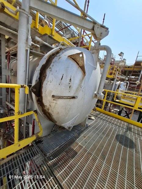

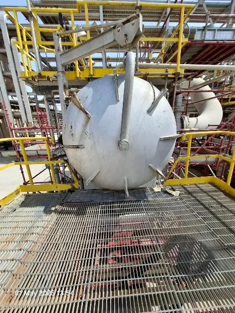

I have a gas filter separator cup and I need to open in without using a crane or a chain block, it is 42inch.
Can any one give me an idea !!

I have seen it done with a turnbuckle to take the weight at the top, on a short swing arm or rail, with a diagonal stay.
The cup weight is more critical than the diameter.
Make sure the turnbuckle is rated well in excess of the cup weight.
Another solution is a flat skid that rests on the deck or floor, with arms that reach up and bolt to the cup. Undo the flanges, then slide it away to gain access.

Is your problem the separation from the body?
If so, why?
I see that you have a swing hoist for supporting of the cup once separated.

How much does it weigh when removed?
I can't see the attachment method.
Also, I can only guess that whatever is to be done there, you will need to put it back at the end.
In short: you will likely need to build a proper (two-way) support structure in situ. And that'll be engineering.
To be completely honest, if there’s no support equipment or procedure already developed for the task, this should be documented thoroughly and run up the chain in the company, preferably as a safety issue.

We only know what you tell us. You have not shown us how it comes apart, nor have you shown us why that jib crane cannot do the job. How heavy is that end cap? You also need to convince us that you will do it safely. As you see from the responses so far, we are just guessing at what you are trying to do. We need more information, then we can help.
Safety is very important on this forum. You have not told us what you have done so far and we are not mind readers, so we have to assume that you have not done anything.
