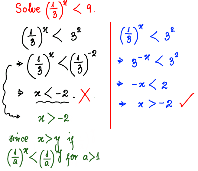

Problem Statement : Solve the inequality : ##\left( \dfrac{1}{3} \right)^x<9##.
Attempts: I copy and paste my attempt below using Autodesk Sketchbook##^{\circledR}##. The two attempts are shown in colours black and blue.
Handwritten solution comparing two attempts to solve (1/3)^x < 9. Left in black: rewriting as (1/3)^x < (1/3)^-2 and concluding x < -2, marked with a red cross. Right in blue: writing 3^-x < 3^2, then -x < 2, then x > -2, marked with a red check.
Issue : On checking, the first attempt in black turns out to be incorrect. But I don't understand why.
A hint would be welcome.
Hi,
If ## 0<a<1## what can you say about ##x## and ##y## when you look at ## a^x## wrt ## a^y## ?

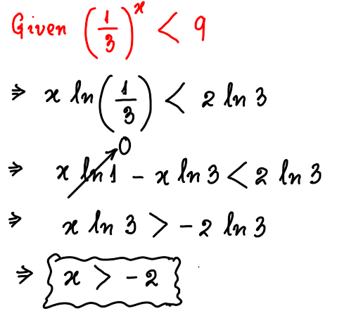

It seems you could try applying ln or other logs on both sides.

Powers of fractions less than 1 work differently. Which is larger, ##1/3## or ##1/3^2##?
BvU said:
Hi,
Let me take an example. Let ##a = \frac{1}{2}##, ##x=3## and ##y=4##. We have ##\left(\frac{1}{2}\right)^3 = \frac{1}{8}## and ##\left(\frac{1}{2}\right)^4=\frac{1}{16}##. Thus as ##x<y##, ##a^x>a^y##.
Let me see.
Handwritten derivation solving (1/3)^x < 9 by taking natural logs: x ln(1/3) < 2 ln 3, then x ln 1 - x ln 3 < 2 ln 3, then x ln 3 > -2 ln 3, giving boxed result x > -2.
It solves the problem but doesn't answer my doubt in post# 1 above.
yes while ##3<3^2##, ##\frac{1}{3}>\frac{1}{3^2}##

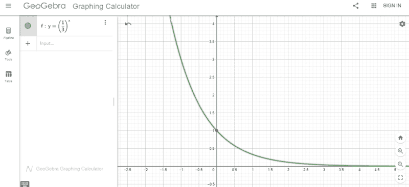

Alternative: plot ##{1\over 3}^x## :smile:
Yes I can see where you getting at. I paste the graph below :
GeoGebra graph of the exponential function y = (1/3)^x, decreasing from the upper left through (0, 1) and approaching the x-axis toward the right; x-axis from -2.5 to 5, y-axis from -0.5 to 4.
I think I have spotted my error. Namely that if ##\left(\frac{1}{a}\right)^x<\left(\frac{1}{a}\right)^y\Rightarrow x>y\;\;\forall a>1##.
I correct my error back in post#1 writing below the black ink in green.
Handwritten solution to the inequality (1/3)^x < 9: left column shows a crossed-out wrong step leading to x < -2, and a green correction gives x > -2; right column shows the correct steps 3^(-x) < 3^2, -x < 2, x > -2, with a red check mark.
