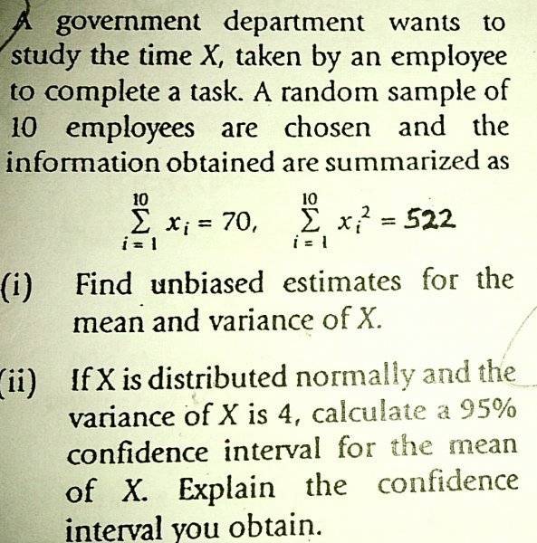

please allow me to post the whole question here...
A government wants to study X , the time taken by an employee are chosen and the information obtained is summarised as sum of X= 70 , sum of X^2 = 522 ..
(i) Find unbiased estimate for mean and variance X
(2) If X is distributed normally and the variance of X is 4 . Calculate a 95% confidence interval for the mean of X .
the attached photo is the whole question and my attempt of the solution...
Please do not post thumbnails; they are unreadable on some media. Anyway, why bother posting a thumbnail of the problem, as you seem to have written out the basics of the problem already? Now, just type out the solution.
