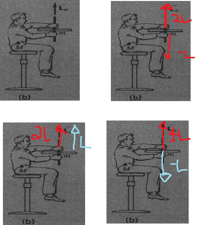

Why is not this sequence below right?:
Four-panel diagram of a man seated on a rotating stool holding a spinning bicycle wheel, with red and light blue arrows and labels such as L, 2L, and -L marking angular momentum at each step.
At first, +L, so the man inverts the wheel and he now has +2L
So he give the wheel to assistent, who inverts the wheel, now wheel +L, the assistant give it to the man.
The man + wheel have now +3L, the wheel is inverted and so, the man + stool finish with +4L
You are correct. The text is incorrect.
The text gets a little too fast and loose with the accounting, jumping from ##3L\omega## (for stool+man+wheel) to ##5L\omega## (for stool+man alone). Changing system configuration and system boundaries both in the same step is just asking for trouble.
You've done that accounting properly.
