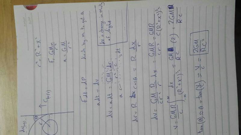

Did not find anything yet. Just call me Rashid, I am a second year undergrad :-p. Started learning GR on my own with some help from PF!.
Okey, I started like this. I was curious about the light deflection so I did what you did. Let me calculate one for you and see if that helps clear some things :smile:
I hope this helps. My last post said Sin. make it tan and I used the change of velocity here to get the angle.

But bobie, GM/Rc has the units of velocity (m/s) how is it the force?
I see, you want the F that when divided by will get you the angle. I think you mixed up some stuff in your calculation because your "Force" (GM/Rc) is actually the velocity component that deviated from the straight path the photon was travelling. and you divide that by the straight path (C) velocity to get the angle.
Velocity change?
Since in this quasi-Newtonian mumbo jumbo we considered the photons to be some sort of capsules that has mass. Then it has a variable velocity.

We have Fg = GM/R2, which is the acceleration a point-mass gets in 1 sec at distance R from the sun, right?
If you integrate this value to find the acceleration it gets in 200 sec, whatever units you get , it's always acceleration (Fg) isnt' it? we merge the formula together but the gist is
Fg in 1 sec = 27500, Fg in 200 sec = Fg * (R/C = 2.5) = 128000.
I am not an expert in units, but the logic is that, right?
I made my example using c as unit, so R is 7c = 7(.5)*1010 cm and the orbit of the photon grazing the sun as radius 7c.
In Newtonian orbits , both for planets and electrons, we find the required acceleration to make an objet bend its trajectory by 1 radiant multiplying momentum/velocity by the ratio velocity/radius of the orbit (v*v/r= v2/r) I was trying to apply the same formulas I use for other orbits. Is it a total mess?

Integrate with respect to what? for example, if you integrated acceleration with respect to time then you get velocity.
I am afraid that I lost you here again bobie.

Most likely a mess bobie. BUT You should try again slowly and with no numbers. Numbers are calculated at the last stage. You will get it eventually!

money you earned. But there above, you integrated acceleration which is, in this money analogy, $7 per hour per hour. When you integrate you get $7 per hour.
bobie said:
But now I am beginning to understand why you talk about velocity v/c , is that so?
so you find acceleration per second 27500, integrate and get velocity 128 000?
then you divide it by C and you get what? what are now the units of v/C ? it should be a dimensionless number for what I know, why should it be an angle?
I think you are getting at it. So, you know that [itex]tan(θ)≈θ[/itex] for small θ, right? Now if you take a look at the paper I attached earlier, you will see that [itex]tan(o/a)=tan(v/c)≈v/c=θ[/itex]

Just forget your numbers. Do it again and calculate the numbers at the last moment.

what is here [itex]tan(o/a)=tan(v/c)≈v/c=θ[/itex]
if 200/10^6 =θ, what is that?
Mr-R said:
, you know that [itex]tan(θ)≈θ[/itex] for small θ, right? [/itex]
and what happens when the angle is not small, for example near a BH?
Could someone please confirm or correct that?
For a small angle it is sinθ ≈ tanθ , and not ≈θ ?
In this case v/c = 0.000004233, tan-1 = θ =0.0002425 and sin θ = 0.000004223
can you also explain what is θ for the deflection of the Earth by the Sun in 200 sec:
tanθ = 200/106 = 0.0002
Is this angle small enough to consider tan-1

Thanks Nugatory,
I am trying to understand the rationale of the formula, in the first place:
the ray is moving tangentially at 3*1010 cm/s
it gets a normal velocity 127 700 cm/s , right?
when we divide v/c = 127 700/3*1010 = tanθ = 0.000004256 we are dividing the legs of a rectangle and we get tan θ, which should be the angle of deflection, right?
Why do you need to approximate the tangent to the angle or to its sine,
why don't you simply do tan-1 θ ?
Is that really so? it doesn't make sense, apparently, as the pull is perpendicular to the motion
