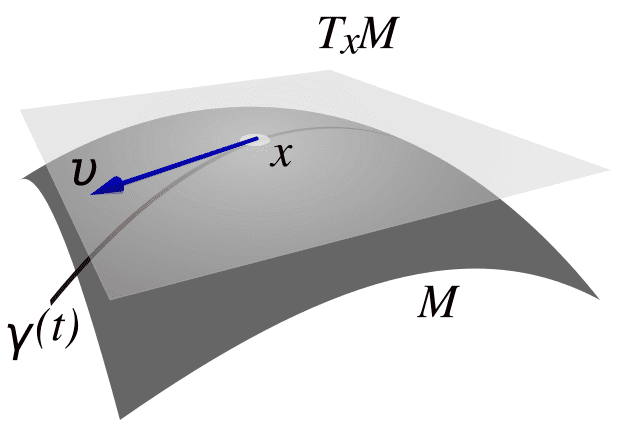

Let's start by imagining the curved 2d surface of some 3d object, which we will call M (think Manifold) and another 2d surface, P which is a flat plane, tangent to M at some particular point. I'll borrow a wiki image that's close:
"Tetrads", which only have two vectors, because it's a 2d surface, span the tangent plane P. Any unit vector v in the space of P will have some counterpart geodesic curve, ##\gamma## that exists in M rather than P, that starts out "in the same direction" as v.
You need some idea of a geodesic to appreciate this, in GR the "shortest distance between two points" will do. Otherwise you have the problem of a lot of curves being associated with every vector v, rather than just one.
You can mark lengths along the curve ##\gamma##, and via this mechanism associate vectors that have both a magnitude and a direction with points on M, by using the direction of the vector v to pick out the curve ##\gamma## that "goes in the same direction", and the length of the vector to pick out some point that's the specified distance along the curve away from the origin. (The origin is where P touches M).
Up until the point where your geodesic curves ##\gamma## cross, you can take a point on M, convert it back to a point on P via the above mapping technique, and express the coordinates of the point in M by the coordinates on the flat plane P which you already know how to do in terms of "tetrads".
Your coordinate system, which is the Reimann normal coordinate system, only handles points in the region before geodesics cross.
