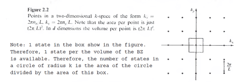

Consider a cubic box of size L. Then periodic boundary conditions imply that kx=nx*2pi/L where nx=0,1,2,3,... The same follows for ky and kz.
Now you can see that in k-space a state with a given k occupies a k-space volume of (2pi/L)^3. Then the number of states per unit volume is (1/V) L^3 * 2 /(2pi)^3 and you get that result. The factor of 2 comes from the fact that the electron has 2 distinct values for the z component of the spin. Note that if you consider a rectangular box you would obtain an identical conclusion.
I have attached a figure from Ashcroft and Mermin.
Do this. In the case of 2D, take the reciprocal lattice and you draw a circle or radius k from the center.
How many electrons states you would have in that area encircled in k-space? If you can figure this out, you can easily find the answer you are looking for. Also, in the case of electrons, there are 2 electrons allowed for each state (spin).
If all else fails, you can use this formula. [itex]g(E)dE = 2g(k)dk/\nabla_k E(k)[/itex]
