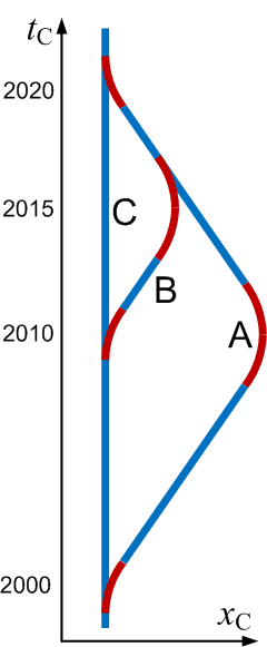

The main trick to solving the twin paradox is asking which observer did the most acceleration, since it was solved by considering doppler shift when under acceleration. But in this case they both accelerated by the same amount. They should see each others clock speed up by the same amount when they both meet so that the clocks would read the same when they met, if they both in fact accelerate by the same amount upon reaching each other. So each observer would see that the others clock ran slower until they both came to a complete stop where they met.
Actually, if both accelerate between meetings it doesn't matter who did "the most acceleration", what matter is their overall paths through spacetime. For example, here is a nice diagram DrGreg did a while ago showing three observers A, B, and C who start at the same position in 2000, move apart, then later reunite in 2020; you can see that A and B have an identical set of three accelerations (shown in red), but A will be significantly younger when they reunite because his path diverges more from the inertial path C (and this would still be true even if you altered the diagram so that A spent somewhat less time accelerating than B).
(A) Would have been traveling a longer distance and then would have to have gone under a higher amount of acceleration during the periods in red if the diagram is to scale. It would take more to make that turn traveling at a greater speed and a greater speed to travel a longer distance.
The reason the clock speeds up in the doppler example is because one observer will be able to receive more pulses of light so then it receives it faster than the information is sent. I wouldn't say that an object went under more or less time dilation being in a situation where the amount of doppler shift was altered by the direction of motion, since it has nothing to do with the amount of dilation put on the object itself. It only allows the observer to contuinuely see the clock run a bit faster so that it is at the correct setting when the two observers meet at a location.
I don't think relativity states that a relative direction of motion itself causes spacetime dialation, there would have to be other factors causeing it in any case.
Nope, the amount of acceleration has nothing to do with distance. The length and magnitude of the acceleration just determine the change in velocity, and A and B both have the same velocity before acceleration, and they also both have the same velocity after acceleration, so their accelerations can be identical. The reason A travels a greater distance is just that A spends a longer time coasting at constant velocity before accelerating.
