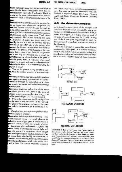

i have this question from wheeler and taylor book, the answer is that bomb does get explode but i don't know how to explain it obviously T is acclerating so it's not an inertail frame, but still i don't see how will an observer in U see an explosion take place, anyone care to explain, has it got to do with simulatenity?
thnkasin advance.
the pic is in the attachment.

Realize that an observer in U will see the top of the T smack into the U, while the long arm of the T keeps going. (Since signals cannot travel faster than c, the T cannot be considered a rigid body that stops as a whole when one end is stopped.)
so the answer is there are no rigid bodies, and when the first time the top T smack the U, the T keeps moving with the U so the arms of the U get eventaully shoretend and kaboom, is this correct or am i way off?

What do you mean when you say "the arms of the U get eventaully shoretend"? In this problem we assume the U is solid enough that it isn't affected significantly when it's hit by the T, so no matter what frame you pick, the U's length and velocity will remain constant. The point is that the top of the T is stopped when it hits the top of the U, but the bottom of the T can't "know" what happened to the top until a shock wave moving slower than the speed of light travels from the top of the T to the bottom, until that happens the bottom of the T will keep moving along at constant speed. And even if the shock wave traveled at exactly the speed of light it still wouldn't reach the bottom of the T before the bottom of the T hit the bottom of the U (we know this because there is a 'spacelike separation' between the event of the top of the T hitting the top of the U and the event of the bottom of the T hitting the bottom of the U...you can prove there's a spacelike separation by noting that if there's one frame where the T is shorter than the U, and another frame where the U is shorter than the T, then there must be a frame where the T is the same length as the U, and in this frame the two events would be simultaneous...if some pair of events are simultaneous in one frame, they have a spacelike separation in all frames).

so the long arm of T keeps moving while the shockwave from the back gets to the front up to that event the arm keeps moving and it gets to the TNT, but then it means that the back is deformed while T keeps moving, so the first picture is wrong cause T's shape doesn't stay the same as pervect argued there.
