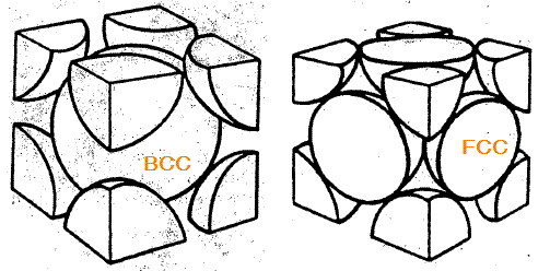

From my understanding of per unit cell for fcc is 4 and bcc is 2.. the way i know this is by counting the solid spheres as in the attached pic..
Thank you
Thank you
That is the number of lattice sites per unit cell. You need to perform a similar counting for the number of interstitial sites per unit cell. And there are two kinds of such interstitial sites: octahedral and tetrahederal.

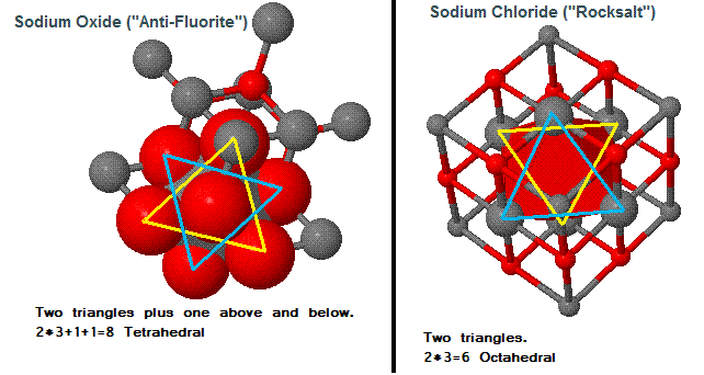

"the particular sphere being considered covers a triangular void in the layer above it and another in the layer below it. Thus two more tetrahedral voids surround the spheres. This results in 2 * 3 + 1 + 1 = 8 tetrahedral voids and 2 * 3 = 6 octahedral voids surrounding the sphere. Since a tetrahedral void is shared by four spheres, there are twice as many tetrahedral voids as there are spheres. Similarly, since an octahedral void is surrounded by six spheres, there are as many octahedral voids as there are spheres"
maybe a picture of this may help me understand it better..

but now I'm still confused on the 2*3=6 octahedral voids and 2*3+1+1=8 tetrahedral voids.. lol sorry
How to you determine no. of octahedral/tetrahedral voids around sphere..
(2*3=6 oct, 2*3+1+1=8 tet)
What is the best way to visualise this?
Hey All..
I found the answer I worked it out... found a useful site so thought I will share :)
Very good for crystal structures.. exactly what I needed to help visualise the stuff..
Heres the link: http://firstyear.chem.usyd.edu.au/calculators/solid_state.shtml?tab=2
The answer to my question above.. Voids around sphere for tetrahedral/octahedral
I have attached a picture..
