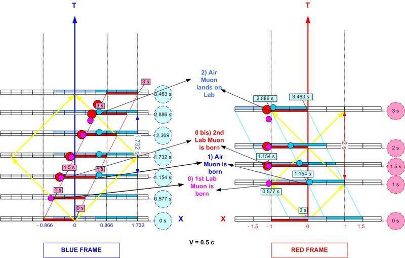

But please clarify this to me. It is my understanding that, logically, since simultaneity in SR is relative, the muon's lifetime is found to be extended ONLY from the perspective of the lab, as per the lab's simultaneity line. But from the perspective of the muon-frame, as per the muon's simultaneity line, it is the lab the one that suffers time dilation. Thus, for example, if a muon is created at rest with the lab at the same time, as measured in the lab frame, as the traveling muon:
- the judgment in the lab-frame will be that the the traveling muon's clock is time dilated and that is why it has made it to the target and
- the judgment in the muon-frame is that the lab muon has decayed because it was created earlier as "himself", but if another lab muon had been created right when "he" was born, that second lab muon would not have decayed and would in fact outlive "him", because its time is dilated.
Is this understanding right? Or, on the contrary, do any experiments prove that lab muons live less in an "absolute" sense?

Mainly right. Essentially, the muon will appear to live for more ticks of the labs clock than on its own (identical) clock.
Not sure what's happening so I can't answer.
No, no, no. There's no 'absolute', only Lorentz invariant quantities.
You must be clear about 'time-dilation' and the elapsed time on clocks. All observers agree on elapsed times ( when clocks are brought together ) but time-dilation is frame dependent. This makes a lot of people mad.
Do you want to see a space-time diagram of the muon scenario ?

Well, if we are sure about "something" with regard to the lab-frame, then we must be as sure as to the same "something" with regard to the muon-frame. It's just a question of applying the rules of the theory to the other perspective.
I had myself drawn this one. It'd be nice to hear your comments. Obviously in mine the numbers are not realistic, since I use v=0.5 c, an Earth atmosphere (the red frame in the drawing) of 1 ls and a half-life of the muon of 1.8 s, just because I'm used to calculations with this sort of numbers, but I'd be glad to see another diagram with the real magnitudes.

Hi saw,
those pics are a bit cluttered but I can see the life of one muon in the lab frame and in the muons frame and that looks OK. I'm not sure why the atmosphere is there. I guess you've answered your own question.
