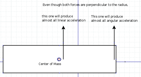

Then how do you explain this?
Both forces produce the same instantaneous linear acceleration, but different instantaneous angular accelerations.

When you apply a force to an object, be it a polygon or otherwise, you do two calculations:
1. Apply the force to the center-of-gravity (COG)
2. Take the cross product of the radius to the point of application, with the force, to obtain the torque
Why, you might ask? Think of the object as a system of separate particles. When you apply a force to a particle that is offset from the COG (of the system!), immediately that particle wants to tug away at F / (mass of the particle). However, since it's linked to all the other particles in your object, you get this system of internal forces - the particle pulls on the system, and the system pulls back. Your input force is therefore distributed to all the particles in the system, through their constraints.
The rotation is a totally different game. It's the effect that your force has on the orientation of the system - but torque-induced rotation is caused entirely by INTERNAL forces. Thus, if you start dividing your torque into perpendicular/parallel components, you're actually throwing away some of the input force.

But my Vector class is 2D, but it appears that the cross product must be 3D. But when to think of it, only the Z axis could be perpendicular to the x, y plane, so can I just calculate the Z axis and ignore X and Y?
And how exactly do you convert a 3D vector into a scalar rotation value?
XY of the cross product will be zero anyway if Z=0 in both input vectors
Generally you take the norm, but here it is just Z.
