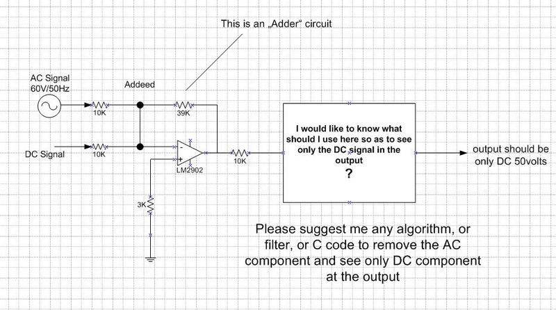

Dear friends,
I would like to know how can I remove an AC signal from a signal which is combination of AC+DC. AC signal 60V/50Hz DC=50V.
Please suggest me a C code or any algoritham or a filter which can remove AC signal completely and I should be able to see only DC signal in the out put.
with best regards,
Sandhi :(
You would not be able to filter out the 60 Hz component.
The AC input of 60 volts would overdrive the amplifier and the gain of 3.9 would make it worse if that was possible. The output would just be a 50 Hz square wave
If you had an input of 0.6 volts, it may be possible to reduce the AC component in the output, but not remove it completely. You could put a large capacitor to ground after the 10 K resistor.
Try 25 uF.
I am sorry to tell that I have mentioned wrong value. It is 5V/1Hz Ac signal and 12 V DC signal.
The 1 Hz signal would make things difficult, but there is a bigger problem.
12 volts DC into an amplifier with a gain of -3.9 will give an output of -46.8 volts.
Now, unless you have a supply of +/- 50 volts this is going to overload your amplifier.
Apart from that, filters for 1 Hz are not really practical. You can do calculations and design a filter, but the component values will become very large and expensive.

At 0.5 Hz, the capacitor has a reactance of 106103 ohms. The net impedance of the capacitor and resistor combination is 9.956 Kohms. So, really the capacitor has no effect.
In series with 1.01 Mohm, the output is 9.56 / 1010 or 0.00946 times the input voltage or 0.047 volts. Without the capacitor, it would be 0.0495 volts.
0.5 Hz is 1 cycle every 2 seconds. This is a very low frequency. What are you actually doing?
I am trying to calculate Rf by measuring the signal at Rm which I call it as Um. When there is no capacitance it is very simple to calculate Rf but with varying capacitance Ce and Rf I need to calculate du/dt to the signal measured at Rm i.e to Um volts. Um is almost like a squarewave.

This is the homework section, so the rules apply. This type of problem is solved by a process of steps, not really one formula.
You might like to have a look at this:
https://www.physicsforums.com/showthread.php?t=362836
It should tell you how to work out the impedance of a parallel RC network. You can add currents as vectors if they are flowing in the same wire, but you can't add impedances if they are in parallel.
You will also need to work out the reactance of a capacitor.
This is given by:
where F is in Hz and C is in Farads.
