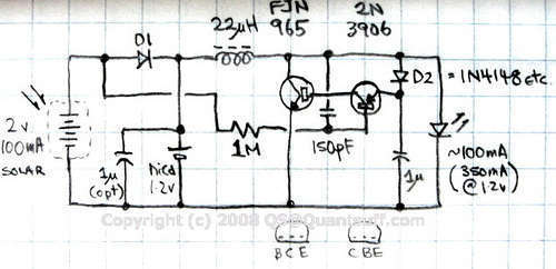

I found this page which has circuit diagram of a solar light on it.
http://www.instructables.com/id/STW6I05FJOH98XJ/
This one uses a single AA cell and an oscillator that steps up the voltage to run a white LED (which has to have about 3 volts on it).
Changeover from charging the battery to operating the light is achieved with the single 1 M bias resistor which turns the PNP transistor on if the solar panel voltage drops below the battery voltage.
The two transistors form an oscillator if the 1 M bias resistor has little or no voltage on it at the solar panel end.
I include this just for the schematic, but if you wanted to reproduce it you can just follow the article.
The real star of this circuit is the driver transistor, FJN965, from Fairchild Semi. Capable of handling up to 5-amps of current in a TO-92 case, it will start at .9v and run the light until the battery drops to under 0.3-volts. You can get them from http://fairchildsemi.com
The FJN965 is Fairchild's rebranded version of the 2SD965. You can substitute the 2SC2500 here as well.
That looks very helpful, thank you!
Here's a question I am going to throw out there; if I wanted to have 2, or 3 LEDs instead of 1, how would I have to modify the circuit? Simply greater batteries/solar cells, or would it get more complicated?
In that article, there are questions at the bottom.
One of them asks the same question and the author suggests a solution. Have a read of it.
