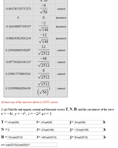

Find the unit tangent, normal and binormal vectors T,N,B , and the curvature of the curve
x=−4t y=−t2 z=−2t3 at t=1.
I found T=(-4/sqrt(56),-2/sqrt(56),-6/sqrt(56)) which is correct. But I keep getting N wrong? PLease help me, thank you!
Looks good as far as it goes. Hard to say what you are doing wrong unless you show us what you are doing to get N.
N = T'/|T'|
so the first term should be 0; but the webwork keeps denying that answer.
N = (0,-2/sqrt(148),-12/sqrt(148)) and that gives a wrong answer

I believe your answers are incorrect, as I have all T,B, curvature correct in the attached image above. Your T, however, has the same i value as mine, which is 0 and incorrect.
T=[-0.53454,-0.26727,-0.80181]
N=[0.81053,0.10665,-0.57592]
B=[0.23942,-0.95771,0.15962]
Maple rules.
Okay Maple rules do give correct answers. Thanks. But I don't understand why they would give different answers to the "conventional" methods. I'm confused about when to use Maple rules and when not?
I made a mistake earlier while using the conventional method. The correct way is:
N(t) = T'(t)/||T'(t)|| = (r'(t) x (r''(t) x r'(t)))/(||r'(t)||*||r''(t) x r'(t)||) = <304/(8*sqrt(157)*sqrt(14)), 40/(8*sqrt(157)*sqrt(14)), -216/(8*sqrt(157)*sqrt(14))>
DUH. It all checks out.
