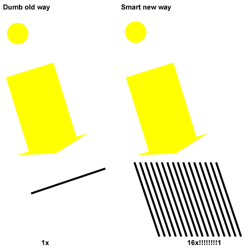

If he is right, would it mean that if you want to collect the sun’s energy in a small area, it would be best to place collectors at close to parallel to the sun’s rays as possible without overlapping, sort of like louvers? I haven’t seen any solar collectors like that. Thanks!
Waitaminnit! Your friend is really on to something! He could make millions!
See diagram.

HAHA!YES!Thats very interesting idea! in your second graph, indeed won't much light will reflect, the efficiency can be maximised, however I m just wonder how much cost for one sun panel.
Great idea:)

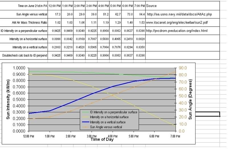

Hello again. Thanks again for all of the information.
What started my conversation with my friend was that I thought that the sun was strongest on my front/back (when standing) at about 6pm versus 1pm. He thought that due to the increased thickness of the atmosphere as the sun gets lower in the sky, that the sun is not nearly as strong, even on vertical surfaces, at 6pm.
He still thinks that is the case, so thanks to some of your information I looked up some equations and tried to calculate it. Attached is an Excel spreadsheet and picture of what I came up with, including the sources. It does show the sun stronger at 6pm on vertical surfaces, but I'm not 100% sure that I did it correctly. Please feel free to correct me if you find an error on my calculations. I don't need super accurate equations. I just need a relative value between close to high noon and closer to sunset. Thanks!

Well, now you've thrown a monkey wrench into the works.
Your question has changed to become:
Which is a bigger influence on exposure: incident angle of sun to exposed surface? or thickness of atmosphere due to height of sun above horizon?
That is a completely different animal!
Yes DaveC426913, you are correct. As we were discussing about sunburn on the back/front of a standing person, we got into the disagreement about what I initially posted the question about, which was so black-and-white that I had to try to confirm one way or another. He now accepts that correction and says that was just a minor point of his view (it seemed major to me at the time), and says that his major point was/is the thickness of the atmosphere. Thanks!
I think I will start a new topic to discuss sun exposure on the back/front at near sunset versus exposure on top of head at noon, since it definitely is a different topic. Thanks.
