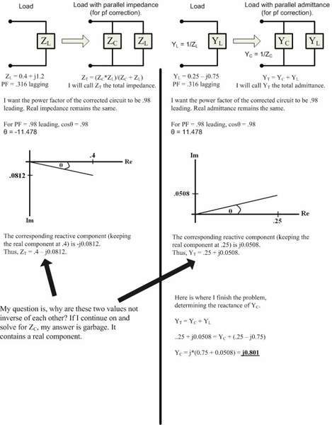

I've been working on a mathematical problem for a few days now. I'm not sure where my math is falling apart.
I have an impedance connected in series with a source. In phasor notation, the impedance is 1.2649 at 71.565 degrees. In rectangular, this impedance is .4 + j1.2 . The power factor for this circuit is 0.32 lagging. I would like to make the circuit have a power factor of .98 leading, while retaining the original resistance (.4).
One solution is to place a component in parallel that provides reactive compensation.
I have attempted the solution in two ways. One is to convert the impedance into admittance, since parallel admittances add together (making the math simpler). The other way is to work through the math of two parallel impedances.
When I try the problem via admittance values, I get a final answer that is a capacitor. This makes sense, as any additional real resistance will change the real power dissipation of the total circuit (my goal here is to make sure real power dissipation stays the same, even with power factor correction).
When I try the problem via impedance values, my parallel component does not solve to the inverse value of the parallel admittance component I found in my first solution.
In fact, when I calculate what the total impedance should be (load in parallel with component), my answer does not equal the inverse of the admittance.
The total admittance I get from my first solution is .25 + j0.0508.
The total impedance I get from my second solution is .4 - j0.0812.
These two values are not inverse of each other. Why is that?

I just finished drawing it up.
skeptic2 said:
To answer that question we would need to see you calculations.
You can see, I try to solve the problem two separate ways: one via impedance, one via admittance. I am able to find the right-handed solution, but not the left. Why are the two values for total impedance/admittance inverse of each other? They should be, since I took the load impedance and admittance values and calculated what the necessary total values should be for the same power factor.
When you add capacitance in parallel to an inductive impedance, you increase the value of R. In order to maintain R at the same value, you must add reactance in series. Your answer of 0.4 -j0.0812 is correct for a PF of 0.98. All you have to do is subtract the inductive reactance from that for the total capacitive reactance you need to add in series.

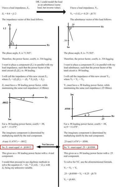

Gladly! Here are the mathematics. I've highlighted my conundrum.
Note: Stating again, my problem is that those two values should be inverse of each other. The total impedance (Zt) (power factor corrected) should be the inverse of the total admittance (Yt). In the end, you're analyzing the same circuit, so why shouldn't they be inverse?
OR
Where am I going wrong with my math?

I had my file size too large. I've attached it as a .jpg. However, the quality might be too poor. So I've included a URL as well.

Zl = 0.4 + j1.2
For a PF of 0.98 and a real part of 0.4, the imaginary part must be 0.4 * sin(acos(.98))/-0.98 = -j0.08122.
My way:
The reactance that must be added in series to get that value is -j0.08122 - j1.2 = -j1.28122.
Your way:
To find Zc given Zl and Zt
Zc = (Zl * Zt) / (Zl - Zt)
Zl mag = sqrt(0.4^2 + 1.2^2) = 1.264911
Zt mag = sqrt(0.4^2 + -0.08122^2) = 0.408163
(Zl * Zt) mag = Zl mag * Zt mag = 0.51629
Zl ang = atan(1.2 / 0.4) = 1.249046 radians
Zt ang = atan(-0.08122 / 0.4) = -0.20033 radians
(Zl * Zt) ang = Zl + Zt = 1.249 + -0.20033 = 1.0487 radians
Zl - Zt = (0.4 +j1.2) - (0.4 - j0.08122) = 0.8 + j1.28122
(Zl - Zt) mag = sqrt(0.8^2 + 1.28122^2) = 1.28122
(Zl - Zt) ang = atan(1.28122 / 08) = -1.5708
(Zl * Zt) / (Zl - Zt) mag = 0.51629 / 1.28122 = 0.402967
(Zl * Zt) / (Zl - Zt) ang = 1.0487 - 1.5708 = -0.52209
Zc real = 0.402967 * cos(-0.52209) = 0.349284
Zc imag = 0.402967 * sin(-0.52209) = -0.200955
There are two ways to get convert 0.4 + j1.2 to 0.4 - 0.08122. The first is to add 0 - j1.28122 in series. The second is to add 0.349284 - j0.200955 in parallel.

Alright. So you say that the second way is to add an impedance of 0.349284 - j0.200955 in parallel to my load impedance.
It is safe to say that this would be the same as adding an admittance of 1/(0.349284 - j0.200955) in parallel to my load admittance (.25 - j0.75)? The total admittance at this point would be (.25-j0.75) + (2.15099-j1.2375431), which equals 2.40099 + j.487543. This is not the same answer that I got in my admittance-based calculations (I determined that the final admittance would be .25 + j0.0508.
Perhaps this touches on some concept of duality that I'm not getting?
Yes it is safe to say that this would be the same as adding an admittance of 1/(0.349284 - j0.200955) in parallel to the load admittance (.25 - j0.75). However, 1/(0.349284 - j0.200955) is not 2.15099 - j1.2375431 but 2.15099 + j1.2375431 which when added to 0.25 - j0.75 equals 2.400998 + j0.487543. 1/(2.400998 + j0.487543) = 0.4 - j0.081223.

Alright, I understand your math. I agree that you can place 0.349284 - j0.200955 in parallel with the load to get the desired impedance. What I don't understand is why you can also add an admittance of j0.801 in parallel and get the same circuit. You see in my right-hand calculations, the YC is j0.801 in parallel with the load admittance. Do you agree that this is the same as placing a 1/(j0.801) impedance in parallel with the load? This would be an impedance of -j1.2489. So my right side calculations show that you can add an impedance of -j1.2489 in parallel with the load. Your parallel impedance calculations also show that you can add 0.349284 - j0.200955 in parallel to the load. To me, that's two different circuits, and that's why I don't understand how both answers are right. Like I posted earlier, perhaps there's a concept of duality I am missing here?
Also, thank you for entertaining the questions.
No I don't agree. You cannot add a reactance to an impedance in parallel without affecting the value of the real part of the impedance. Complex arithmetic is not always intuitive. This is why I wanted to see your work, to see where the error was. It is also why I showed you my work, so you could follow the arithmetic.

The mistake you're making in all this is a false assumption that if you keep .25 as the real part of the final load expressed as an admittance, that when expressed as an impedance, its real part will be .4, which is your requirement.
So, you're saying that if someone asked me to correct the power factor of a known load without changing the real impedance, I would not be able to do so by running the calculations via parallel admittance values (as I tried to do)?
Nope, that's not what I said.
What I said is, if you want to do things on an admittance basis, you can't get the answer you want by keeping the real part of the admittance equal to .25, which is what you did so far.
Your goal is to keep the real part of the impedance equal to .4, and that's what you have to do, whether you do things on an admittance or impedance basis.

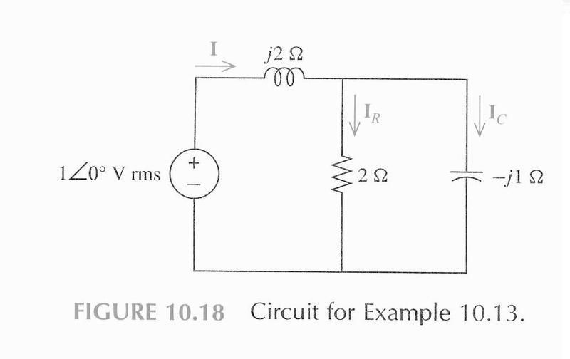

Electric Circuit Analysis, Third Edition
David E. Johnson, Johnny R. Johnson, John L. Hilburn, Peter D. Scott
ISBN 0-471-36571-8
I emailed Peter Scott (no reply, yet).
I guess, reading the problem now, the authors never did say that they meant to maintain the real impedance. I just think it would be crazy to correct the pf of a circuit and totally change the amount of power it will actually absorb (or at least, not take into account that it would change). Is this normal practice for pf correction? I used this text twice in undergrad. I've been working in the power industry for about a year now, and I decided I would refresh myself on the math. That's when I came across this problem. I agree with you about the intuition.
Do you have your own intuition about this phenomenon? I mean, when working with resistance/conductance, you could work an equation from start to finish in the exact same manner using either perspective, and wind up with the same result. With reactivity/susceptivity, it seems this doesn't hold true (thus, you had to determine the initial/final impedances and THEN convert to admittance). If you have a way of thinking about this, I'd love to hear it. Or perhaps you just drink the coolaid?
I've attached scans of the problem and its referenced figure.
