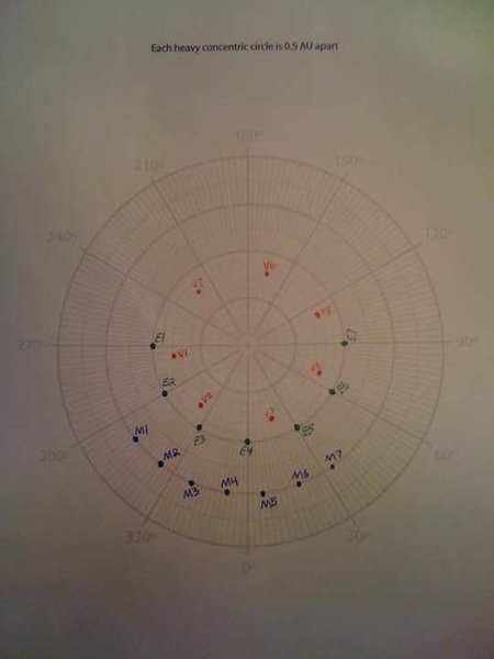

Given the following: Its a polar graph.
I am trying to figure out when is VENUS visable in the sky during this period (dawn, dusk, noon, midnight) ?
How do you figure that out? Also, Venus is red, Earth is green on the chart.
Thanks!

Is it at all possible that Venus is visible at midnight?
Also, remember that the Earth rotates in the same direction that it revolves around the sun (counter-clockwise in your graph). This should help you figure out when it is visible in the morning, and when in the evening. Try drawing the Earth as a larger circle, instead of a dot, and draw on which part of the Earth it is day and which it is night.

Without doing your homework for you, chronologically the Earth at E1 corresponds to the position of Venus at V1, and so forth. Since the Earth turns on its axis so that planetfall brings the Sun into view in the east, then E spins counterclockwise in your diagram. So V1 will come into view first for E1 and then the Sun at the center of your diagram will come into view. Thus, Venus comes into view in the early morning (before sunrise) for the Earth at E1.

V5 looks like it would be visible for some time from E5 before sunrise.
A point on E1 is/has been facing away from the Sun when M1 is in view, so night viewing.

E1 through E7 represent points in Earth's year; each one is a few weeks apart. At any given one of them, Earth is spinning on its axis like a top - these are its days.
Imagining yourself standing on that dot that is Earth, you are spinning counterclockwise, round and round. No, forget imagining - draw it. Draw a dot on the Earth's dot that represents you, standing on the Earth.
From your point of view, a little dot on the bigger dot, which is rotating counterclockwsie, the sun will move past you from left to right. It will rise on your left and set on your right. When the Earth dot rotates so that the you-dot is directly away from the Sun, that is midnight to you, when the you-dot is pointed directly at the sun, that is noon to you.
This is key. Understanding this CCW rotation is the key to knowing the day-night cycle of Earth, particularly when it is sunrise and when its sunset.
Now, as the you-dot observes the sun rise on its left and set on its right, where is Mars? Is Mars ever visible in you-dot's sky at the same time as the Sun? As you-dot rotates, does Mars become visible before the Sun becomes visible? Does Mars stay visible after the Sun sets?
As you were suggested several times - replace dots with small circles, and put a dot - which will be observer - on the planet surface. When observer is close to the Sun - what time is it? When observer is on the other side of the circle - what time is it? Is it possible to see Venus when you are on the side opposite to Sun?
