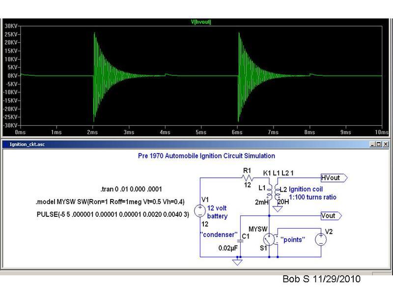

Hello Adrian-
Here in thumbnail is a simulation of a pre-1970 automobile ignition circuit showing a 25-kV voltage pulse. Resistor R1 (which includes coil primary resistance) should be chosen to limit dc current to about 1 or 2 amps. You should be able to find an ignition coil and condenser in a local junkyard.
Note in simulation that the voltage pulse occurs when the points open, and not when they close. (The very small pulses at 0 ms, 4 ms, and 8 ms are the points closing). Why is there a large voltage pulse only when the points open?
edit The above simulation is of course for charging the primary coil inductance to 1 amp using a 12 volt car battery. You could build a small dc-dc converter (9 volt battery to 300 volts), like in this stun gun circuit below, charge a capacitor to ≈300 volts, and discharge it into an automobile ignition coil or similar transformer. What you will need is the charging circuit like in
http://www.sentex.ca/~mec1995/circ/hv/stungun/stungun.html
In this circuit below (circuit3), a 9 volt dc dc converter charges C2
http://www.personalarms.com/schematics.htm
to about 300 volts, and T2 is an ignition coil.
These are all dangerous circuits. be careful.
Bob S
After opening, the current through L1 changes very quickly due to the LC component values in the resulting oscillatory circuit.
After closing, the current through L1 is built up quite slowly due to the series resistance.
Only a quick change in the current through L1 produces a high voltage output for the spark plugs.
Here in thumbnail is the basic configuration for a capacitor discharge ignition circuit. The thumbnail shows a 30 kV spark from a capacitor charged to 300 volts. The capacitor charging resistor R1 can be increased to 1 meg to limit charging current to about 0.3 milliamps. The RC time constant would then be 20 milliseconds. The output voltage pulse is about 100 times the capacitor voltage. For example, 50 volts on the capacitor will give a 5000 volt output pulse.
Bob S
