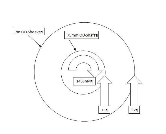

I guess what keeps blowing my mind is if I look at this assembly like the attached picture.
If I apply force F1, large enough to sall the motor, then the force required to stall it will be less at F2. Therefore, the force at F2 would be what is aviable to the belt and next pulley.
Thought comment suggestions on this?

I may be oversimplifying here but...
No, the torque doesn't change. You have 1450 Nm of turning force - whether it is applied over a small or large distance, it remains 1450 Nm.
Think of a bolt that requires 100 Nm of tightening torque. You have a socket set with 2 bars, one 1.0 m long and one 0.5 m long. To apply the same torque to the bolt, the 1.0 m bar requires 100 N applied to the end. The 0.5 m bar requires 200 N applied. In your example, the torque applied by your motor to a small shaft or a large pulley will be the same. 1450 Nm.
The resultant force will not - it will vary in proportion to the radius. A shaft of (e.g.) 0.1 m will produce a tangent force of 14,500 N (1,450 N / 0.1 m) and a pulley of (e.g) 1.0 m will produce a tangent force of 1,450 N (1,450 N / 1.0 m).
It may help to imagine your shaft and pulley as 2 different levers welded to the motor spindle. One is 37.5 mm long (the shaft) and one is 88.9 mm long (the pulley). Clearly the shorter lever will need more force to stall the motor.

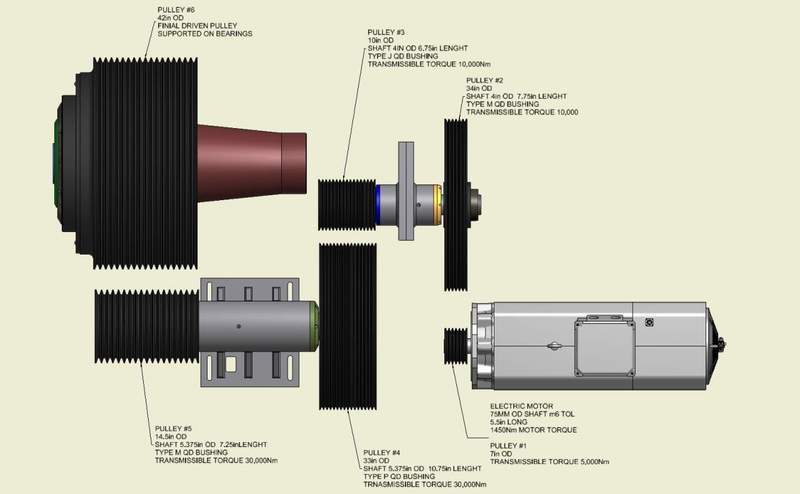

Because, I keep thinking about it in that way. As a 3.5in(88.9mm) lever driving the belt, therefore I want to take the resultant force from the 7in motor pulley and multiply it by the radius of the 34in pulley to determine the torque applied at the larger pulley. (7in and 34in make up stage 1 in my belt drive) 1450Nm/0.0889m=16310.5N leaving the 7in motor pulley.
Torque at the 34in pulley is 16310.5N*0.4318=7042Nm
Instead of doing 1450NM (34/7)= 7042Nm Which makes the assumption that the resultant force is equal.
Ok, Light bulb moment, I see the error in my thinking. In my initial question I was trying to calculate a different torque at the motor pulley, which cannot happen, but I can have a different resultant force at the larger radius.
So continuing on through the drive train, pulley #2 (34in one from above) and pulley #3 (10in OD) are rigidly fixed on the same axle/jackshaft. Therefore torque in = torque out, power in=power out and rpm in =rpm out. We know the torque from above at the 34in pulley is 7042Nm. The resultant force at Pulley #3 is 7042Nm/0.127m=55448.8N Moving out to Pulley #4 with a 33in od. The torque is 55448.8N*0.4191=23238.6Nm (7042Nm*(33/10)=23238.6Nm)
