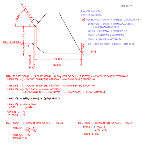

Hi,
I just signed up with the forum. I have a degree in Mechanical Design, have been working as a drafter. It's been about 10 years since I've done any statics and wanted to re-learn this stuff by making a bucket loader for my garden tractor. The last few months I've been reading my Statics and Strengths of Materials book. I think I might have confused myself.
I'm currently working on the bucket and want to analysis the forces on the hydraulic ram pin A, and the solid arm at Pin B.
I've tried to do this in different ways and keep getting different answers. It's frustrating when you don't have someone to tell you what you are doing right or wrong.
The attachments below show a diagram and my forces of 500lbs to lift and also my 850#'s my tractor can push. Each step I show what I did along with the math.
I'm not sure if I'm correct on this. I'm pretty sure I have my forces balanced in the X direction, but when I go though using SIN 30.47 degrees to sum forces in the Y direction, I get a much bigger, unrealistic number. I found out if I use the compliment angle SIN 59.63 it comes out correctly.
This confuses me because if I use right angle trig I should be using 30.47degrees for to find the opposite leg.
Can someone check my work and let me know if what I have so far is correct? If so; How do I go about finding the balancing forces in the Y direction?
I appreciate any help.
Thank you,
Rob

A couple of things
1. compliment angle of 30.47 is 59.53 degrees
2 For your momnets, you have to include that from the 500 pound force acting at a distance of 20.50
3. Resolve you forces into x and y compnents in a diagram - you already have the 500 and the 850 pounds so leave them as Fx and Fy at the tip as is - it is visually easier to see what is going on and not forget about a force.
4. If pinned at both ends, which it would have to be, you can assume the force of the ram acts at the angle of the ram as you have done in your moment calculation ( include the 500# force moment) at the angle of 51 degrees.
5. At the pivot you do not know the angle of the force - that you determine after you have sovled for the Fx and Fy at the pivot. You seem to assume that if you have some sort of arm at an angle of 54 degrees the force is transferred through the arm at 54 degree angle. That would be somewhat true if the pivot is pinned at both ends, which you readily can understand is impossible - the arm has to be fixed at the upper end to your tractor.
6 Limit your decimal places to one digit - 500# and 850 # is resolved into a force of 986 # ( not 986.15). One decimal used just as a placeholder would be 986.2#. (0.15 is about 2 ounces - do you need that much accuracy )
Positive x to the right, positive y up
In the x direction : Fpivot_x + Fram_x = 850
In the y direction : Fpivot_y + Fram_y = 500
Moments : re-adjust your moment calculation
I have attached a new PDF. Are the forces correct? I think they are, because they balance out. I also think I'm wrong because the forces on the pins A, and B. seem high.
If this is correct. I take the forces and transfer them to the arm, but they will be opposite in direction. I can then sum forces around E to find D and then sum forces in the X/Y direction again.
If am correct on this, I will have a few more questions once I get the arm figured out.
Thanks for all the help!
Rob
grandnat_6: Regarding your pdf in post 5 ...
(1) summation(Mb) = 0 = 20.563*500 + 6.25*850 - 6.50*Fa*cos(51 deg), where Fa = axial force in hydraulic cylinder AC. Therefore, solving for Fa gives, Fa = 3812.2 lbf (16.96 kN).
(2) summation(Fx) = 0 = -850 - 3812.2*cos(51 deg) + Fbx. Therefore, Fbx = 3249.1 lbf (14.45 kN).
(3) summation(Fy) = 0 = -500 + 3812.2*sin(51 deg) + Fby. Therefore, Fby = -2462.6 lbf (-10.95 kN).
nvn has corrected your arithmetic, since you had somne geometry wrong (the perpendicular distance for the 850 force )

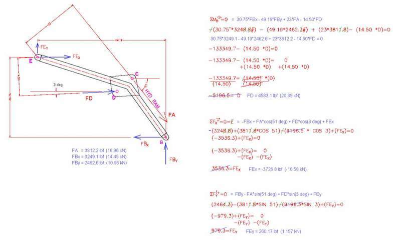

Ok,
On the attached I have rotated the structure and it's forces so beam 1 is horizontal. I then made a chart to break these forces down in there horizontal x, and vertical y components.
I then added the horizontal x, and vertical y components respectively per the pins they are acting on.
When I did my shear diagram, none of my forces have crossed the zero line, nor did they balance out to zero.
Were did I go wrong?

I have attached my new work. Please note dimensions have changed. I got up to the same point we left off. My moment diagram did not seem correct again because it does not return to zero. I did some reading in my statics book, I have not read it in the book, but I think it is probably correct since pin E and D are basically holding the beam and the forces on pin B act as a cantiliver. My book does not show an example of a couple and a force acting on the same point, but I have noticed if I add the force of the couple of 65200.00"# acting on pin B to my maximium moment of -65193, I'm within 7lbs.
My book says not to add the force going though the distance you are taking moments from, but does not say anything about a couple. So I'd assume the couple does not get added either?
Thanks.
grandnat_6: First, I have a question about dimensions. Please provide dimensions a1, a2, and a3, highlighted in blue, in the attached file. Dimension a1 is at the exact intersection of the centerlines of beam 1 and beam 2.
By the way, this time, your file is blurry, and I am having trouble reading some of your numbers. Also, if you can, try to save your files using only 16 colors, not millions of colors.
I thought you would want to add 60 % of the weight of your hydraulic cylinders and beams to the vertical load applied to your bucket tip. Did you decide not to?
Your first calculation is wrong. I marked it in the attached file. Not only did you make a mistake calculating the final Fa answer, you also forgot to include the y component of Fa in your Mb moment summation (because Fay is offset horizontally from point B). I stopped checking here, because this will make all of your subsequent calculations wrong. Try again.

I could not read your blue text either. Do you mean I forgot the force of FBy and not FAy?

grandnat_6: What do you mean you could not read my blue text? Can you not zoom in? Was that blue color faded, or what? If you cannot read my shade of blue text, what color do you want me to use for my mark-up? Black, or dark blue, or what?
No, in your first file in post 24, when summing moments about point B, you forgot to include the moment about point B caused by FAy. As shown in my post 23 file, when you do this, you will obtain FA = 3155.30 lbf.
nvn,
At lunch today I read your reply. The blue text used to mark up my drawings is good. I just can't make it out in the last file you marked up. Probably due to the blurriness. Last night I tried three different computer programs to zoom in. I also printed it out and used a magnifying glass both on the print out and the screen. I could not make it out.
I worked on trying to get the FA=3155.30lbf. I could not get it. I knew in the back of my mind since pin A is not in line with pin B it probably would not be worked the same. I think the problem is in finding FAy. The only thing that makes sense to me is to take the moment of 500lbs*20.563" and then divide by the distance of .57" = 18038.0lbs
I then took that and added it to my 13681.5lbsf obtained in my original problem. Then dividing by 7.4375" to obtain 4264.8lbsf. finally dividing 4264.8lbf by the cos of 58.841 which equals 8242.5lbf.
Please take the time to mark up my bucket forces in post 24.
Thank you.

nvn, Thanks for telling me what FA is. I think I figured it out in the attached bucket forces.pdf.
Re-cap, Since the pins of A and B are in line on the first bucket, the force going though pin A in the Y direction does not produce a moment because the force goes though pin B and you can not use a force going though a point you are summing moments from. Thus pin b in the X direction can, so all the forces acting on it must go through the X direction to be balanced reaction force.
On the second bucket since pin A is offset from pin B in both the X and Y direction a moment is produced in both X and Y of pin B. Since FA has two directions they must be included.
I do have a few questions about this.
What happens if the bucket was pined to a wall by pins A and B in both situations? Is there only an X directed force in both cases on pin B or will the reacting forces be the same as in our first and second bucket analysis? Are there any rules to follow when doing this?
The equation in black on the bucket forces pdf; what is the rule to cancel out the X, and Y to obtain FA? I mean, FAx and FAy are the same forces but they are in different directions so how does the X and Y cancel out?
I also attached my arm forces. I am hoping for a good report.
Thank you.
