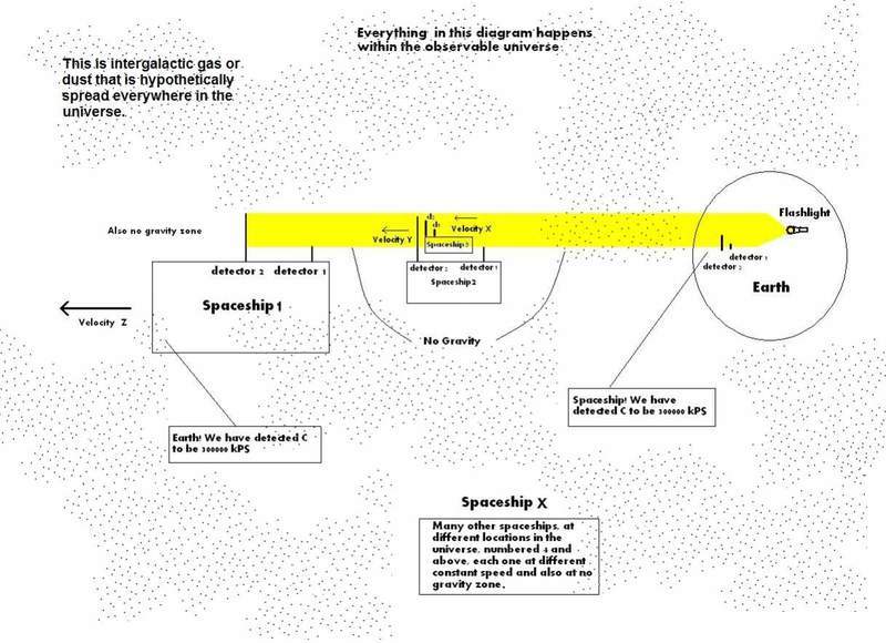

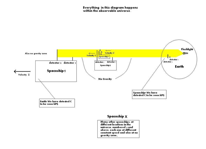

OK. Please look at the attached diagram. Will any spaceship from the group 'spaceship x', observe any change in light speed, before or after light enters detectors d1 and d2, located on spaceship3?

The three common "event horizons" to appear are those for black holes, the one for the observable universe, and the Rindler's horizon for accelerating observers.
None of these can really be fully dealt with using only special relativity. In the Rindler's case, one can do some of the analysis using only SR. One can, for example, deduce that constantly accelerated observers travel on hyperbolas.
All local measurements of the speed of light will result in c. This is true also in general relativity.
I thought we resolved your questions with regard to your diagram in posts 10 through 15 of Why is light speed constant in all reference frames?
This question goes further. But Indeed, first i need to be as sure as possible, of the meaning, of what i am asking, for the answerers may render the rest of the question redundant.

I might need to add some kind of 'intergalactic dust' to my diagram, in order to be able to ask what i want to ask, but still there is probably a distance to make, before i am sure the scenario i want to represent, is coherent.
In order for that to happen, what i want to ask now, is this:
