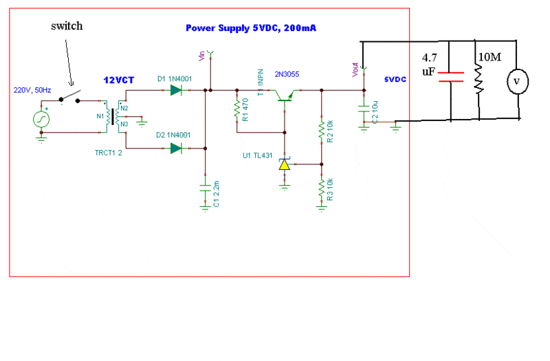

In lab, we built a circuit with a 4.7 micro-F capacitor hooked up to a DC source. In parallel to the capacitor was a 10megaOhm resistance voltmeter. We used the voltmeter to find the voltage drop across the resistor and find the RC constant (supposing unknown C). We would turn on the battery, charge up the capacitor, then turn off the battery and take watch/record the values in the voltmeter.
My question has to do with the following: Say we started at 1V and read measurements at 0.9, 0.8, 0.7 V etc, as the voltage decreased. Well, when the capacitor was charged at 1V, when we turned the battery off, the voltage would decrease, then start increasing back to 1, and then start steadily decreasing. I had not expected that increase in the voltage. I though it would decrease smoothly from 1 to 0.9 etc. Nobody could explain the temporary increase to me. Can somebody help me explain why the voltage increased and then decreased? Thanks.

Sorry for bring up the topic again. Was that a battery or a power supply? Power supplies have internal capacitor and also output resistance.
If it was a power supply, then the phenomenon can be explained easily.
It was a power supply.
See what happens if, instead of using the switch on the power supply, you manually disconnect a wire (or both wires) going from the power supply to the capacitor.
The figure shows a typical power supply circuit. Look at R2 and R3 of the circuit. The series of R2 and R3 is parallel with the 4.7 uF capacitor.
When you turn of the switch ( see the location of the switch in the figure), the 4.7uF and the output 10uF capacitors discharges through R1+R2=20K. The time constant is about (10+4.7)*.02=.294 seconds. That's why the voltage drops to zero almost immediately.
Then, the remaining voltage of the internal capacitor C1=2.2mF=2200 uF starts charging the 4.7 uF transistor through all possible resistors of the circuit. Then both capacitors discharge gradually.
The right way to measure the time constant is to disconnect the output. I think the time constant you measured is not the time constant of your parallel RC circuit.

there was no external resistor. The voltmeter itself (the multimeter) has a resistance of 10Mohms. But, what do you mean disconnect the output? Do you mean remove one of the wires leading into/out of the power supply?
In your experiment, the switch must isolate your capacitor from the power supply. The on-off switch does not do so.
In the simplest way, just disconnect one of the wires which connect the power supply to the capacitor. This isolates the circuit from the power supply.
