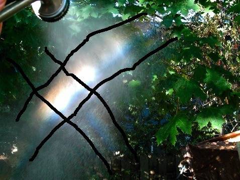

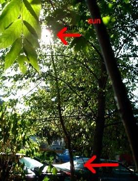

I just did an experiment trying to show this, and saw something that I could not explain.
I saw two rainbows that intersected at almost a 90° angle.
A bit hard to see. And I scratched my head for a minute or two trying to figure it out, as this type of phenomena could only be explained if there were two light sources.
So I turned around and noticed that one of my car's rear windows was reflecting light, out of line with the sun, and explained the second light source.
But I thought that would make a fun experiment.
Get the class together on a sunny morning with several mirrors in different locations all reflecting sunlight onto a single area, then spritz the air with a water hose mister or a spritz bottle, and see how many different rainbows you could see.
