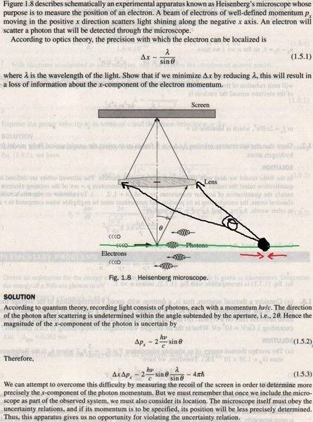

The problem and its solution are attached as TheProblemAndSolution.jpg.
Δx = λ/sinθ
Δp_x = 2h/λ sinθ
In the equation given in the problem (Δx = λ/sinθ), why is the uncertainty of the ELECTRON written as a function of the PHOTON's wavelength (and the microscope's angle)? Similarly, in the equation given in the solution (Δp_x = 2h/λ sinθ), why is the uncertainty in the x component of the momentum of the ELECTRON written, again, as a function of the PHOTON's wavelength (and, again, the microscope's angle)? If it wasn't clear from the above, I am placing emphasis on the fact that Heisenberg's Uncertainty Principle is all about being able to measure, with great certainty, either the position or momentum of the ELECTRON while the other factor remains highly uncertain BY USING CHARACTERISTIC VALUES OF A PHOTON (RATHER THAN AN ELECTRON). I would really appreciate it if someone could tell me why this is the case.

This is not homework. (I don't know if you noticed but, the solution is included in my main post.)
I'm just trying to understand this problem inside-out. I'd appreciate it if I can have an answer that simply addresses my concerns and nothing more (in order to not confuse me or add unnecessary difficulty).
the size of an object which you want to take a picture of must be at least as large as the wavelength of light which you use to take the picture. This is a law of optics. (You can work it out using classical wave theory). Therefore, the uncertainty in the electron's position will scale with the wavelength of the photon.
And the uncertainty of the momentum of the electron is the same as the uncertainty in the momentum of the photon. This is because momentum is conserved in the collision, so if the photon had an uncertainty in its momentum, then after the collision, the electron will have an uncertainty in its momentum.
Before I ask my other questions, I'd like to ask: Is Δx the right arrow from the collision point to the top of the arrow (touching the lens)?
no, the arrow from the collision to the lens is meant to show one of the possible paths of the photon.
Δx itself will depend on the experiment, the example doesn't give enough detail really. It is meant to be an instructive example, not something to actually calculate.

It is simple singe-slit diffraction. I.e. if the light comes from a place of width d, then it will end up moving in a direction where theta is less than the theta given by the formula (most of the time). As I said, this is classical physics. So the question is kind of using a mix of classical and quantum reasoning. This question is not doing the calculations very precisely, the point of the question is to give you a feeling of the uncertainty principle, not working knowledge of it.

1) I'm beginning to understand the Δx = λ/sinθ more. Basically, a larger wavelength takes more physical space and needs a larger slit so it can pass through. Also, sinθ will yield a value between 0 (excluded) and 1 (included) meaning that the slit will be larger or equal to the wavelength of the photon and that the photon is somewhere within the slit. In other words, it makes sense to me why Δx and λ are proportional. What doesn't make sense to me is how the sinθ part is there. I would like your help to dive into the single-slit diffraction non-formal “proof” to figure out how to get the sinθ part if you don't mind.
2) I would like to understand how the momentum uncertainty is the Δp_x = 2h/λ sinθ equation. I understand it geometrically so, what I am asking is basically when you said
We know that adding the same constant to each data point doesn't change the spread of the values, therefore the spread is the same.
, how do we know that this constant spread is (always) equal to 2h/λ sinθ? Or is that not what's going on? Assuming what I said so far is correct for #2, can you show that to me mathematically please? I believe an explanation using vector summation would be the one I am looking for.

Good point. 2λ/sinθ is the width of the central peak, but I think they used Δx ~ λ/sinθ because the intensity within the central peak is not uniform, so the spread is not as great as you might first think.
Can you relate what you said in your most recent post (the one before this one that I am writing now) to the concept of a Diffraction-limited system ( http://en.wikipedia.org/wiki/Diffraction-limited_system ) for me please since it seems to be strongly related to what I am asking?
Based on the equation from the Wikipedia link I'm now posting, it seems that Δx ~ λ/(2nsinθ) - -λ/(2nsinθ) = 2λ/(2nsinθ) = λ/(nsinθ) which is λ/sinθ when n = 1 for the problem that is the focus of this thread.
yeah, definitely. The equation Δx ~ λ/sinθ comes from the theory of far-field diffraction. And in this problem, we are saying that our uncertainty of the position of the electron is due to the equation for diffraction.
In the wikipedia page, they are saying the smallest resolution size is due to diffraction. This is really the same thing as our problem, where the resolution size is the uncertainty of the position of the electron.
