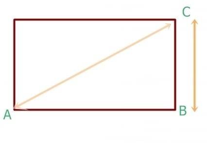

In the following figure is the work done is Same from A to C, and B to C
if it is same then how it is same
AND,,,,,, the Dot product of two scalar always give a scalar quantity ??
Assuming a constant force, then, no it won't be. The distance from A to C is greater than the distance from B to C.

In your picture, there are no forces acting on a body shown, so we cannot tell which path takes more work. You must tell us about the forces.
