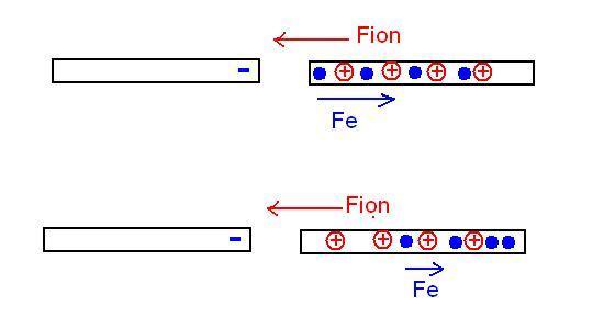

Imagine that the metal rod is fixed to the table so it can not move. You put a negatively charged object near it, say, a plastic rod.
The charges can not move in the plastic rod, but the electrons in the metal can. As for the positive ions of the metal, they are fixed to each other and the whole thing is fixed to the table.
The positive ions experience attraction, the negative electrons feel repulsion. You can imagine that there is an electron in the vicinity of all ions, so every part of the metal is electrically neutral, as in the first top picture. Then the attractive force on an atom is the same as the repulsive force on its electron, the net force on the metal rod is zero.
The repulsive force accelerates the electrons and they move away as far as possible, towards the other end of the metal rod. The ions can not move, they stay where they were. See the picture below: After a very short time, there are ions left without their electrons at the left end of the rod. They experience the same force as before. The electrons are accumulated at the other end of the rod, farther from the charged rod: They experience smaller forces. The rod consists of its ions and electrons. The forces exerted to the ions and electrons add and it is a net attractive force on the rod .
ehild
Oh so during process where the electrons move away from the positive ions, actually there should be a net attractive force already? Since now the distance between the positive ions and the negative plastic rod is smaller as compared to the electrons and the plastic rod?
Just at the very instant that the electron leaves the leftmost atom, there is a net electric force of the rod. If you keep the rod firm, it can not move. Only you need to exert a bit bigger force.

The metal rod consists of its ions and electrons. The ions are arranged in a certain way and can not leave their position. The electrons are free to move inside the metal but can not leave the metal.
The external charge brought close to the metal rod acts on all constituents, both ions and electrons. Also all particles of the metal interact with each other. Every particle feels a force from the external charge (external force) and forces of interaction from the other particles. The interaction forces keep the ions and electrons together and make the metal move as a single body. The sum of all external forces determine the acceleration of the rod as whole.
The external negative charge attracts the ions and repels the electrons. That force of repulsion is a bit smaller than the attraction as the electrons are accumulated in the farther part of the rod. So the net force on the rod as whole is attractive. Discussion like that would be better on the forum "General Physics". This is not homework.
ehild
