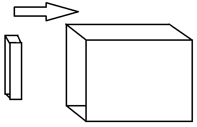

I'm making a box that can change volume quickly with an actuator for a small project.
But I need to minimize the friction in moving the wall of the box.
Is there a way to make a magnetic track for the wall to 'slide' on? I don't mind if there are boards sticking out the back of the 'wall' to help balance it (I was going to put wheels on it originally), I just need the inside of the box to be box-like.

What if I basically made a track for the wall like that, placed magnets on the right and left so that it wasn't touching the sides, and pushed it? Would it get stuck?
Is there a way to maybe produce two rails that could attach to the wall that would have nearly no friction? Like below?

Attaching magnets will increase the mass of the moving side; is that likely to upset your plans that movement be speedy? How heavy is the moveable side?
... it also won't be air-tight.
There's all sorts of stuff you can do with magnets - like you could exploit diamagnetic levitation. You pic of the railing looks interesting - just rotate the inner 45 degrees.
There's something nagging the back of my mind about rapidly accelerating magnets inducing funny fields meaning it may be counter productive.
The simple answer to your question:
... is "yes", there are lots of ways.
But I'm with NascentOxygen - it could be counterproductive.
I'm not sure you are addressing your design constraints - how fast do you want to move the wall? What are your energy restrictions? How big is this wall? ... and so on.
The box should be 3 foot x 3 foot on the open side.
I suspected that might be the case, that it might not be something I could do effectively without making things more difficult.
Thank you guys for the response, I'm going to give this one up and go with some ball bearings, and mount the box's wall on some drawer sliders instead.
