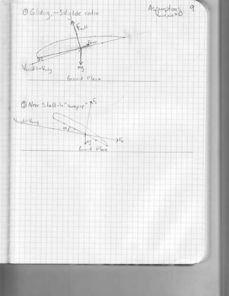

OK, good clarification. There is still something missing then. If the "thrust factor", which I thought was coming from lift, is not, then it must be coming from drag. See the attached picture. In part one, what force am I missing that causes forward acceleration, if it's not lift. Also, do you have gmail to chat, it would be much faster.
