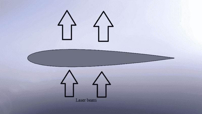

Based on picture 1, this is my expected experiment configuration.
I use acrylic for so that the PIV laser beam can pass through the transparent acrylic.

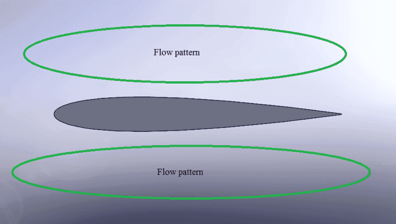

The picture 2 shows that the shape (with flow pattern) i would like to capture from CCD camera (from top view).
Any comment for my experiment setup?

I highly doubt that your laser will pass through acrylic without a significant amount of distortion. Acrylic is not generally optical quality. Additionally, the fact that it is curved means that your beam will be refracted when it passes through the acrylic and you will have an uneven light intensity on the bottom side of your airfoil. In other words, you will have a very difficult time getting PIV simultaneous on the top and bottom. You may have to do the experiment in two parts. You should still use the acrylic though, as it will minimize reflections off the surface of the airfoil.
If you still have issues with mounting and you don't need the airfoil to pitch at all, then you ought to use two rods through the airfoil instead of just one. That should keep it stable in [itex]\alpha[/itex]. Then you just have to pick your favorite method of attaching those rods to the test section I would suggest having your model be almost exactly as wide as your test section so that you effectively split the test section in two, then having the rods go out the sides of the tunnel and securing them on the outside.

Unless you have a material that has the same refractive index as air, you will have to do it in two runs.
You say you are not analyzing the effect of angle of attack. What angle of attack will you be testing at then? Because if you are testing at zero degrees using a NACA 0012 there is no reason to be able to see both sides of the airfoil because it will be symmetrical.

Initially i never think of index of refraction of acrylic, that's why i believe laser beam can pass through acrylic smoothly. ( As shown in picture 1 )
I want to capture flow pattern as shown in picture 2.
Since the laser bream will be refracted, then i should run the experiment in 2 ways which are laser beam emitted to bottom part and then to upper part??
Is that what you guys mean??

Well if you needed the top and the bottom then yes, you would really need to do it once on top and once on bottom. However, the flow field over a NACA 0012 is identical over the top and the bottom assuming it is at zero AoA.
