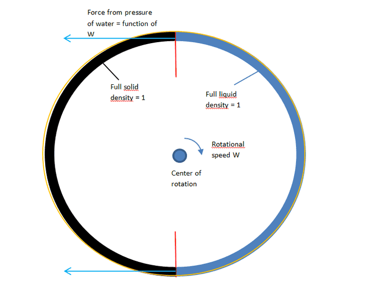

Take half torus with solid part of density 1, other half torus with liquid of density 1. The torus turn at W rd/s enough for maintain liquid at external circle. Now, for 0 to 180° we accelerate torus, this increase forces (blue in drawing) from pressure of water and from 180° to 360° we deccelerate torus. Rotationnal speed change from W to W+w to W. It's like torus change the CG without external forces. I thought solid give pressure too but I can imagine 2 liquids with different density, it's the same. I have some questions:
1/ water don't give pressure so no force exist ?
2/ solid give same pressure ?
3/ when we rotate the forces from rotation, this cancel pressure forces ?

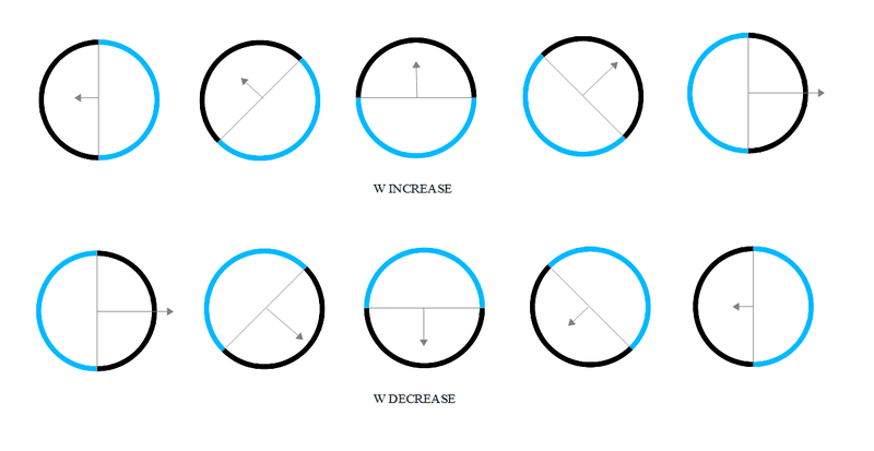

Edit: I add another drawing for show different positions

Maybe my questions are not precise enough ?
When I drawn solid in black, it's possible to imagine it maintain from center of circle with solid like this no pressure can appear from solid (imagine a lot of smal ropes for maintain all part of solid). So if solid don't give pressure, it is liquid that don't give pressure ?

I don't understand exactly what you are doing here, but one difference between the solid and liquid parts is that there must be a container that holds the liquid, and the container will apply a force to the liquid. If you ignore that fact, you will get the wrong forces and stresses.
Does this attachment help?
I'll try to understand this evening. That I can't understand: if I imagine solid half torus like small parts, if each part is attached by a rope, the pressure could be limited a lot I think ?
ok, but this force (the force the container apply) will put on support that take system ?
This is actually a very complicated problem. Based on lots of experience in fluid and solid mechanics modelling, I can tell you that the best way to approach a problem like this is to start with some much simpler versions of the problem, and solve them first, and gradually add complexity until you get to the actual problem you are trying to solve. Why? First of all, if you can't solve the simpler versions of the problem, you certainly won't be able to solve the more complex problem. Secondly, you will gain understanding along the way from the solutions to the simpler problems.
In the system you describe, neither the solid nor the liquid will behave as a rigid body. Both will experience transient non-homogeneous deformations. The liquid will exhibit viscous flow that has to be accounted for, and the solid will exhibit elastic deformation that has to be accounted for. I suggest starting out with the following very simple problem:

Your last sketch is not far off, so we are getting somewhere. I have drawn something similar in fig4 of the new attachment.
Starting with the static situation of a ring or section of a cylinder under internal pressure, Fig1 shows the internal pressure tending to burst apart the ring. This would break it across some diameter, say AA.
The bursting pressures and forces act radially.
Fig2 shows how this bursting is resisted. There must be a forces F-F acting across the section AA, holding the ring together.
These forces exactly equal the bursting forces and are equivalent to the forces F in my earlier diagram in post#3
Fig 3 shows how the forces F-F must be the same all the way round the ring to preserve equilibrium.
The resisting forces are therefore tangential or circumferential.
They are called hoop stresses or forces, after the iron hoops used to hold wooden barrels together.
Now in Fig4 we proceed to a rotating situation. Here the internal pressure is replaced by the a stress due to the increasing radius in the inner and outer faces of a small segment. This is like your last sketch.
The circumferential stresses are considered constant and equal to the hoop stresses described before.
(Note I have moved from forces to stresses the force is obviously stress time cross sectional area.)
Now a rotating disk is not in equilibrium.
However we may use equilibrium analysis if we introduce the fictitious centrifugal force to balance the real centripetal one. This is equal and opposite to the centripetal force and the technique is known as D'Alembert's Principle.
Alternatively we may analyse the motion by Newton's laws of motion using the centripetal acceleration.
I have done this in the previous attachment and called the centrifugal force C.
This equals mass times distance to the centre of mass of the rotating half ring times the square of the angular velocity.
Using D'Alembert allows me to then use the laws of equilibrium to equate this to the two hoop forces acting across the cut line forming the diameter of the half ring.

1/ I come back to the torus when W is constant. Full torus with liquid. Now if we increase the radius of the system, we need kinetics energy for additional liquid sure and increase radius (add water). But the C force is like an additionnal force that increase energy of the system. If the radius increase, we can put water in the center, we need energy for rotate water, ok, but water move outside circle more easily due to the C force.
If I compare the potential energy in a rotational solid and a fluid it's not the same ?
2/ Centrifugal forces apply a pressure like gravity can do. The pressure is more at external with C, it's easier to move an empty object at external circle ? See drawing.
With the shape I drawing, solid and liquid has the same density, I don't know how forces from pressure (F+C) can cancel themselves ?

What makes you think the forces cancel?
It would help if you drew the correct forces.
When analysing a mechanical problem you need to distinguish between applied or external forces (also called loads) and internal forces which appear as stresses.
The response of a liquid is different from the response of a solid to external force.
However the external applied force will be the same in both from the same source.
Please not that Chestermiller has already said this is a very complicated problem (post#6).
In my post 19 I posted a partial differential equation that takes three pages of maths to solve, even after simplifyung to an ordinary differential equation. Are you up for this?
