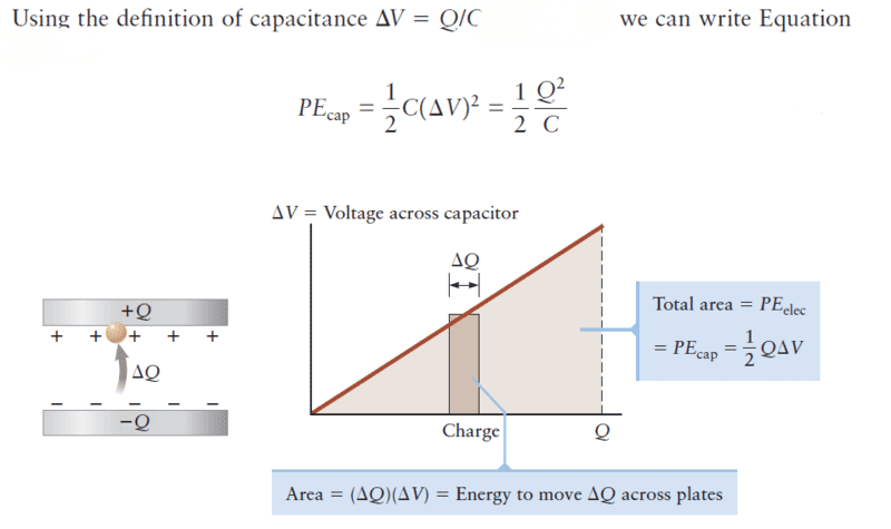

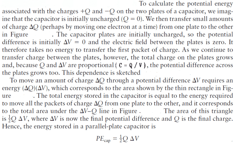

Quote Quote by vanhees71 View Post
Let's first consider the most simple case of a two-plate capacitor with vacuum between its plates. Then you can think of charging it that you transport charges (say electrons) from one plate to the other.
My notes say the exact same thing , I specifically don't understand how can one even imagine this phenomenon ? It is simply false because there is an insulator (air/dielectric)
between the two plates and no charge flows between this space !
Not during charging , not during discharging, Never !
Can you justify your claim ?
Here is a portion of my notes :
