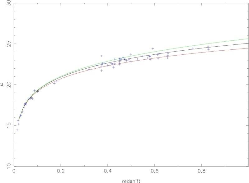

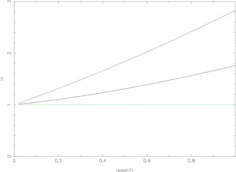

Steady State Cosmology, in which H is constant for all time is simply a terrible model given current data. Indeed, there have been a number of studies that have sought to avoid assuming any model for dark energy and have simply fit the data (supernovae results being the more important) by some function H(z) (z=redshift). The data overwhelmingly demonstrates that H(z) most definitely changes over time. That is before you go into how SSC can explain the observed evolution of structure (i.e. the structure in the Universe is observed to change as a function of redshift), the evolution of the galaxies luminosity function etc etc, the list could go on for some time.
I've made a couple of plots to show how bad the fit is for SSC. The first one shows three curves for H(z). The black line is for the standard LCDM model, although the paramters of this LCDM shown are not the exact best fits, I just put in 0.3,0.7 the best values are similar to this. The red line is for a matter only universe, so no decceleration. The green line is SSC, in which H(z) is always unity. Note that what is plotted is actually H(z)/H(0). Clearly the green line looks very different to the white, which is the one we know fits the data.
To demonstrate the fit to data, I've plotted the distance modulus [tex]\mu[/tex] for these models against some of the supernovae data as a function of redshift (the data are the blue crosses). The data is a little old, there are many more points and points at higher redshift known now but I had these older ones in a data file already. Adding the newer data doesn't change this demonstration. As can be seen, a universe with no acceleration (red line) poorly fits the data. The black line is a good fit while the green line is also clearly a bad fit.
The reason we don't talk about SSC much these days is simply because is performs very poorly at explaining the data. It was a good model when it was developed, since there was less data, but even Hoyle, the champion of the model, accepted that it had been ruled out by the data late in his life. That was data that was much less precise than we have today, that continues to make this model a poorer and poorer fit.

Quote Quote by Wallace View Post
Hi Wallace, thank you for the great data and explanations. Things should always be discussed in the context of direct evidence. I'm curious, the first diagram you showed seems fairly straight forward, but second one seemed more scattered. At a glance, all of the models seem valid (some of the data were beyond the green line). Do you have any advice on how to interpret this graph correctly that I may be missing? Is this older data not as clear as the new data, or as supportive? It's a subtle point, but I think it's one of the more important observations we have made supporting BB and I'm still trying to get my head around it.

Quote Quote by Herbascious J View Post
Note that almost all the blue crosses lie below the green curve, and almost all above the red. The black line goes through the middle of them. Note again that this is not the best fit LCDM model, just a rough (0.3,0.7) so the actual fit is better than the black line. It may seem to the eye that there is not much difference, but this is real data we are talking about that have uncertainties. You have to consider that if the green line was the 'correct' model, what is the chance that almost all the data points happen to have been observed to lie below it, basically equivalent to say tossing 100 heads in a row. Anyway, that's a very rough way of putting it, using proper statistics you could quantify exactly what the odds would be, and they would be very low, hence this is a bad model.
The curve may seem close to each individual point but the key thing is that we must consider all points. If they all lie on one side of a curve that curve can't be a good model.
Edit: Oh and yes, newer data is important. Note that the curves separate more and more at high redshifts. Much of the new data is at a higher redshift than what I have shown, so make the differences between models more stark. This is particularly true for SSC since in that model there is only acceleration, wheares what we find is that SN above about z~1 show that the Universe was decelerating then, followed by the more recent acceleration. SSC doesn't predict this so would perform very poorly for the high redshift data.
Note also the SN are just one observation (although very important admittedly) and the other bits of evidence also suggest deceleration followed by acceleration.
Wallace, again thank you for the great feedback. I apologize if I am 'shooting a dead horse' but in speaking with an associate of mine, I found myself talking about this subject and I realized I didn't have any understanding of how the data is analyzed. Do you have a good explanation of how we are able to find deceleration and acceleration in past epochs with data we have available to us today? I understand that the deeper into space we look, the closer to the Big Bang we are seeing (back in time), but I don't understand how the data is analyzed to draw these conclusions. I'm curious how much of this is interpretive, etc. Any feedback is appreciated. Cheers.
Wallace
Wallace is offline
#12
Jun24-08, 06:07 PM
Sci Advisor
P: 1,253
Supernovae Type 1A are roughly, once you take several factors into account, standard candles. This means that there is a consistency to them, each explosion (when corrected by known factors) is about the same brightness, known to astronomers as the absolute magnitude [tex]M[/tex]. By observing how bright they appear to be, the apparent magnitude [tex]m[/tex] we can then determine how far away they were as a function of redshift, since more distant objects appear dimmer. We can't simply use the normal intensity dropping as 1/distance squared in an expanding general relativistic universe, but instead we need to determine the luminosity distance, [tex] d_L [/tex] which is function that depends on the particular cosmology. This luminosity distance for a given model predicts how the supernovae would appear to us as a function of redshift if they were perfect standard candles and there was no uncertainty in measurement.
What I plotted on the graphs is actually distance modulus [tex] \mu [/tex] which is defined as
[tex] \mu = m - M = 25 + 5 log d_L [/tex]
so for the blue crosses of the data, the difference between the absolute magnitude of SN type 1A and the observed magnitude gives us [tex]\mu[/tex] and then for the curves, the cosmology gives us [tex]d_L[/tex] which is converted to [tex]\mu[/tex] as shown.
In particular
[tex] d_L(z) = \frac{c(1+z)}{H_0} \int_0^z \frac{dz}{H(z)} [/tex]
which is how you get from the graphs I gave of H(z) to the second one. Does that answer your question? Let me know if you need anything clarified, more info etc.
Edit: Note the last formula for luminosity distance is valid only for a flat universe, open and closed universes have a somewhat more complex formula, but the principle is the same.
