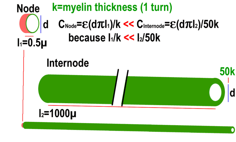

A visual perhaps?
Time constant for internode is, at least, 120 longer in that case.

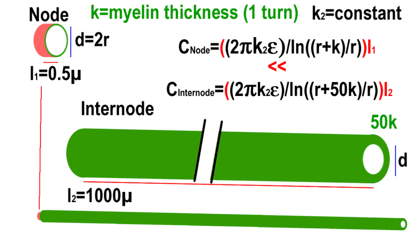

granpa said:
http://sfbay.craigslist.org/forums/?act=Q&ID=102572102
You're right. Normally a cylindrical capacitor must be computed that way but biologists do not.
http://butler.cc.tut.fi/~malmivuo/bem/bembook/21/21.htm
It does not change the length segment problem.

somasimple said:
A visual perhaps?
Time constant~RC, so if you include R (membrane resistance)?
