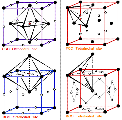

I'm having some problems trying to understand the tetrahedral and octahedral sites in face centered cubic (fcc) and body centered cubic (bcc). It is hard to visualise the structures in 3D..
I wanted to know how to find out the positions per unit cell for the tetrahedral and octahedral in both fcc and bcc..
For the tetraheral
fcc = 8 tetrahedron per unit cell
bcc = 12 tetrahedron per unit cell
The bcc is worked out (6*4)/2 = 12
For the octrahedral
fcc = 4 octrahedron per unit cell
bcc = 6 octrahedron per unit cell
The fcc is worked out (12/4)+1 = 4
The bcc is worked out (12/4)+(6/2) = 6
Although I have the soultions I'm still confused how they are worked out to the above answers..I have attached a picture.. hope someone can help
Thank you
First, count the number of sites (small open circles, in the attached pictures) of each kind. In the FCC there are two kinds of oct-sites, marked in red and white. Do you understand why they are different?
Next, you look at each kind and determine whether or not the site is entirely contained within the unit cell. In the above example, only one kind of site is. Which one?
Whenever a site is shared by more than one unit cell, you need to figure out how many unit cells it is shared between. The white oct-sites on the FCC live on the unit cell edges. How many unit cells share each such edge? Divide the number of shared sites of each type by the number of unit cells that share it*, to get the number per unit cell.
* Note: This division assumes that the site is shared equally by each of the unit cells involved in the sharing. This is often the case (determine by inspection from symmetry), but need not always be.

Thank you for your reply..
My understanding of the topic is very brief so bare with me..
Firstly I'm not sure about the difference between the red and white..
The FCC e.g. you have given is an octahedral site
From my understanding of per unit cell for fcc is 4 and bcc is 2.. the way i know this is by counting the solid spheres as in the attached pic..
Thank you

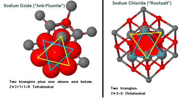

I have also come across this a few times in internet searches (from the link)..
"the particular sphere being considered covers a triangular void in the layer above it and another in the layer below it. Thus two more tetrahedral voids surround the spheres. This results in 2 * 3 + 1 + 1 = 8 tetrahedral voids and 2 * 3 = 6 octahedral voids surrounding the sphere. Since a tetrahedral void is shared by four spheres, there are twice as many tetrahedral voids as there are spheres. Similarly, since an octahedral void is surrounded by six spheres, there are as many octahedral voids as there are spheres"
maybe a picture of this may help me understand it better..

Thanks now I understand what you meant :).. I wasn't dividing! silly mistake .. and rather counting all the circles.. thanks again for that..
but now I'm still confused on the 2*3=6 octahedral voids and 2*3+1+1=8 tetrahedral voids.. lol sorry
How to you determine no. of octahedral/tetrahedral voids around sphere..
(2*3=6 oct, 2*3+1+1=8 tet)
What is the best way to visualise this?
Hey All..
I found the answer I worked it out... found a useful site so thought I will share :)
Very good for crystal structures.. exactly what I needed to help visualise the stuff..
Heres the link: http://firstyear.chem.usyd.edu.au/calculators/solid_state.shtml?tab=2
The answer to my question above.. Voids around sphere for tetrahedral/octahedral
