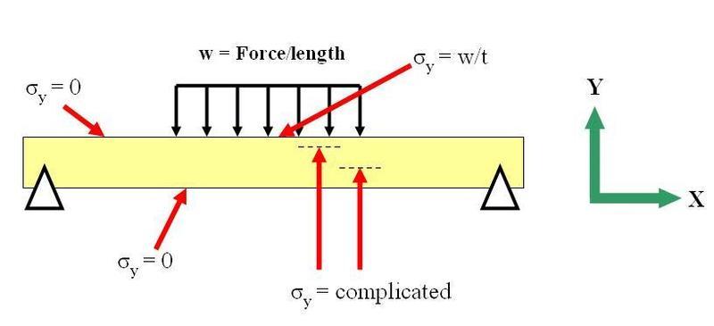

thanks for that rybose, so regarding that 'impure' beinding. if a load has a distributed load, the would [tex]\sigma_y[/tex] be only over the load? i.e. the area which that load is applied.

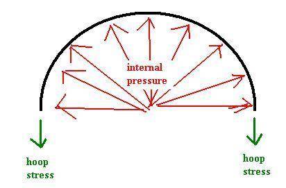

there is a hollow shaft, thin cylinder which has an internal pressure P, a direct force F, and a torque, T. i realize axial stress due to pressure adds with direct stress from tensile force. but where does hoop stress come into it?
normally, if we have a plane at angle theta, we can work out normal and shear stresses through 2 equations, and get [tex]\sigma_n[/tex] and [tex]\tau_x[/tex] or we could use mohr circle.
in this case we don't have a plane and I am unsure as how the hoop+axial, direct and shear all correspond to each other.
a tutorial on principle stresses would be good, if anyone knows any good ones?

Attached is a picture of what I attempted to explain in my previous post.
Yes, on the surface and underneath the load, the lateral stress is simply the load divided by the area.
On the top surface with no load, the lateral stress is zero. On the bottom surface the lateral stress is zero (because there's no load). In more formal language, these are called "traction boundary conditions."
Beneath the surface of the load, things get more complicated. But again in beam applications these are usually very small compared to the other loads.
To visualize hoop stress, imagine cutting a cylinderical pressure vessel longitudinally. In order for the body to be in equilibrium the force from the material stress must equal the net upward force from the internal pressure.
You can derive the thin-walled presure vessel equations by finding the net upward force on the semi-circle (hint: integrate). You might be able to find this in a reference.
