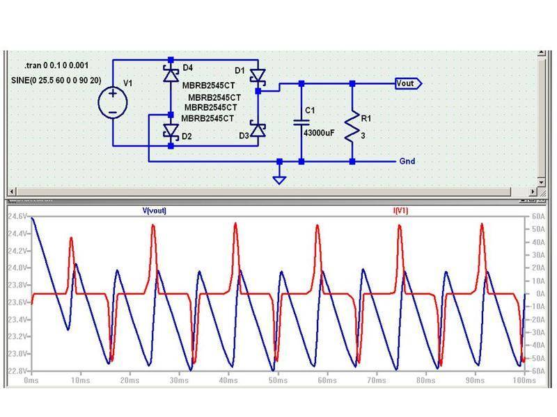

If the power supply has a 43,000 uF capacitor, and the discharge current is 8 amps, using I =C dV/dt, the droop is dV = I dt/C, where dt =~ 1/120 sec.
so the droop is dV = 8/(120 0.043) =~ 1.5 volts. This means that all of the discharge current during a 180 degree half cycle has to be recharged in about 20 degrees of phase. So the instantaneous charging current is about 10 times the 8 amps, or about 80 amps. Because the transformer winding resistance losses go as I-squared R, the winding losses will increase by about a factor of 10 over a circuit with no capacitor.

Here is a thumbnail with (only) a 43,000 uF capacitor. Using 4 Schottky diodes. Input voltage = +/- 25.5 volts peak.
Left scale (blue) output voltage ripple ~ 1 volt, ave volts out about 23.5 volts.
Right scale (red) peak ac input current in V1 ~ +/-50 amps.
Bob S
Bob S.
This would only be true if the charging current were a 100% duty cycle square wave, so that its RMS value was the same as its peak value.
What determines the winding losses is the RMS value of the charging current. The winding losses won't increase by a factor equal to the ratio of the peak charging current to the DC current in the load, but rather by a factor equal to the ratio of the RMS value of the charging current to the DC current.
In your simulation you didn't include an impedance in series with the AC source with a value typical for a transformer with a rated current suitable for the load.
I happen to have a transformer rated for 8 amps at 20 VAC. I wired up a bridge with some high current Schottky diodes, and captured some scope traces of the ripple voltage and charging current with 10,000uF and with 40,000uF capacitances.
The transformer has a series impedance of (130 + j30)milliohms, referred to the secondary with the primary shorted.
The charging current in the two cases is almost the same, because the series impedance of the transformer dominates, but the ripple voltage is much lower with more capacitance, as we would expect.
The first image shows the ripple voltage and the charging current with 10,000uF and the second image shows the same, but with 40,000uF. The DC load current in both cases was 8 amps.
The charging current is much less peaky, with a greater conduction angle, than it would be if the transformer had no series impedance; its peak value is about 25 amps. The RMS value of the charging current is 13.5 amps. The value of I to be used in calculating the I^2*R losses in the windings is the RMS value (13.5 amps), not the peak current (25 amps).
The ratio of RMS winding current to DC load current in this case is 1.6875. A rule of thumb often seen is that for a capacitor input power supply, the transformer VA rating should be about 1.6 times the DC output power.
The upshot of all this is that after the capacitance has reached such a value that the capacitor impedance (at the dv/dt of the rising edge of the ripple waveform) is less than the transformer impedance, adding more capacitance will reduce the ripple voltage with no additional penalty in transformer or diode losses.
