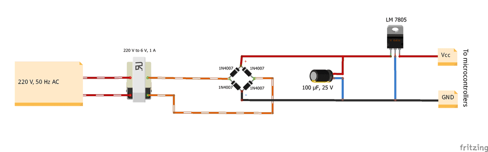

I need to create a 5 V stable DC supply out of 6 V AC from a transformer. By "stable", I mean that I do not want the ripples in the voltage that one gets from the output of a full-wave bridge rectifier. I have to feed this to two ATmega 8A μCs.
I am going to create the following circuit:
6 V RMS means ≈ 8.5 V peak. The capacitor will hopefully smooth out the ripples. The LM 7805 voltage regulator will bring down the voltage to 5 V. I can attach a heat sink to it if it tends to get heated up too much.
I don't yet have all the materials; once I get them, I can use the Arduino analogRead() function to have a look at the waveform of the output of the circuit because I don't have an oscilloscope.
Does this circuit look okay? Any suggestion for improvement?
I wonder if 6V isn't too low for LM7805. Unless I am misreading it datasheet says min 7 V (hardly surprising, each junction eats around 0.6 V, there is probably more than one on the current path, so there is not much margin). I am not sure though how it will work with RMS vs peak. (That's not the only thing I am not sure about, I know next to nothing).
Instead of struggling with analogRead() consider investing in something like DIY DSO138. I have been on that path several years ago, it was worth every cent I paid :wink:
In that case, I can use a 9V transformer.

You don't say how much DC current you need. Your circuit should work fine for very low currents. The capacitor needs to be large enough (WRT your current) to 'stay above' the 7805 minimum input voltage at your desired current (without overloading the transformer). Using a higher-than-required supply voltage (with a linear regulator) results in more heating of the regulator - current (again) is a critical parameter. There are 'LDO' (low dropout) regulators which require less 'headroom' than the venerable 7805.
Likes DaveE
< 1 A.
At 1A, the voltage of a 100uF capacitor will decay at (approx) 10,000 V/S (10V/mS). Ic = CdV/dT. You need the capacitor to 'carry' the load for something approaching 10mS (P-P time for bridge-rectified 50 Hertz). The peak charge currents (from the transformer) will exceed the 1A rating (by a lot) - the peak voltage will be much-reduced (as a result). Your arrangement is probably OK for < 10mA.

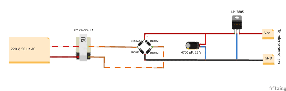

100 uF will be insufficient reservoir capacitance.
The quick design process advances from both ends to meet at the reservoir capacitor.
A 9 volt, 1 amp transformer will droop by about 5% to the specified 9 Vrms when loaded.
That is a peak voltage of 9 * √2 = 12.73 volts.
The two conducting silicon diodes in the bridge will drop about 1 volt each = 10.73 volt.
The regulated output is 5 volt. The regulator dropout voltage is 2 volts higher = 7 volts.
So capacitor ripple must be less than; dv = 10.73 - 7 = 3.73 volts.
For 50 Hz the full wave ripple will be at 100 Hz. That is a period of dt = 10 ms.
The maximum load is 1 amp.
C = Q / V ; by definition, and; Q = I · t ; so C = I · dt / dv.
Required minimum reservoir capacitance; C = 1 A * 0.01 sec / 3.728 V = 0.00268 farad = 2680 uF.
There is no tolerance for components or supply voltage in that computation. Use 4700 uF.

The big problem was the reservoir capacitor. Calculated 2680 uF works, I would use 4700 uF.
Now that is fixed I don't worry too much about the diode conduction angle because as it increases the storage time, dt will be reduced.
Cheap 1 amp Si diodes will show significant resistance above 1 amp. You might replace them with 3A schottky diodes.
You might also halve the transformer resistance by specifying an 18VA transformer, rather than 9VA.
In this model, with a regulated output 1 amp load, the 1 amp Si diodes are dropping 1.35 volt at an Ipeak of 4 amp. You can see how with the original calculated values, that once operating (6ms) the headroom (yellow trace) remains positive.

Thanks a lot for this calculation.
Will the 1N5822 Schottky diode (datasheet here) be suitable in this case?
9V 2A or 18V 1A? Actually I am trying to keep down costs. At first, I thought that I would build my prototype with Arduino and then transfer it to a stripboard and use one ATmega 8A. Then it turned out that the way I have written the code (which I cannot change), one μC won't suffice, and I need another one for reading user input. So I decided to connect the two via Serial communication. 2A transformers are twice the cost of 1A transformers. But 18V 1A is still within the reach.
Which software are you using for this simulation?
Wrichik Basu said:
Will the 1N5822 Schottky diode be suitable in this case?
Those diodes look good.
If you use 4700 uF for the reservoir, and use a schottky diode bridge, you should not have problems with the 9VA transformer.

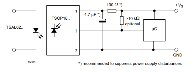

Wrichik, you didn't mention which, if any, Ardiuno sensors you'll be using as many of the sensor packages won't do well with this design, as drawn, because it doesn't have any filtering.
Probably the sensor that would suffer the most is the capacitive touch sensor because the main's common mode is passed completely unattenuated. Good USB chargers for cell phones have common mode chokes to suppress this noise so you use the device while charging. You can tell when you're using a cheap one because the cursor will jitter under your finger. Common mode can be a big problem, especially if you have your circuit plugged into a power strip with a lot of other things also plugged into it.
Since it's just a learning exercise, I wouldn't worry about it too much. But if you have really noisy sensor readings farther down the line, try switching your project to being powered from a high quality USB charger, if the noise goes away you'll know what the culprit is.
This app note has more information on it.
https://www.murata.com/~/media/webrenewal/products/emc/emifil/knowhow/26to30.ashx

I will be using only the TSOP 1838 infrared receiver. It's datasheet shows a circuit that can be used to suppress power supply disturbances, if there are any.
