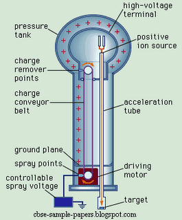

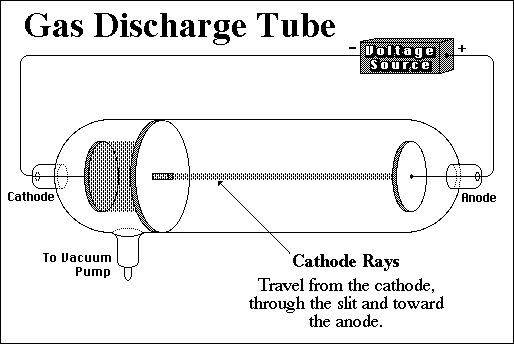

how does battery maintain potential differece meaning behind it & why is it grounded
[quote=sudar_dhoni;2428408]see the attachment
plz explain the function of battery and ground in the picture
my doubt was that in discharge tubes the 2 plates are connected to some voltage source
let it be battery for instance see the fig in this case between the two plates there is empty space then what does the battery here do
does it send electrons to cathode which deposits on it and the cathde induces +charge on the anode and electrons return back
that is my doubt am i right or wrong
but when i consulted my physics teacher he told me that it cant induce to such long distances , he told that what happens is that electrons in anode are attracted by +terminal of the battery and when they reach the +terminal they repel the electrons in the - terminal which goes to the cathode as a result of repulsion
my main doubt is what is the meaning that battery maintains potential difference i cant understand this term can any1 explain in terms of charge movement (not mathematical)

also why is that - terminal of battery is grounded in van de graff
in van de graff current cant flow from battery since it is not open circuit
in many cases circuits will not be complete as in discharge tube vaccuum tube.In these cases battery cant supply current then what else it does
if u answer it maintains potential differece plz tell me the meaning of it and plz explain about my grounding doubt as mentioned in this same quote
Which figure? You have three figures showing two completely different kinds of devices.

first i was referring to discharge tube
next i wanted u to explain the role of battery in van de graff
thats what i want to know the meaning behind what u have stated above (physical meaning like previously u told that voltage is energy gained or lost by unit charge)
OK, so basically a battery does work on an electron as it moves it from the + terminal to the - terminal. For example, in a car battery the chemical reactions do 12 eV of work on each electron resulting in a potential energy increase of 12 Joules for every Coulomb of electrons moved from the + to the - terminal. Or 12 Joules/Coulomb is 12 Volts.
The ground is just an arbitrary place that you call 0 Volts. In other words, you set your potential energy at ground equal to 0. This is completely analogous to the fact that if you are working a problem involving gravitational potential energy (mgh) you can set your h=0 point anywhere you want.
I don't really know anything about van de graff generators, but I will try to answer about cathode ray tubes. Basically, you heat up the cathode until it is so hot that electrons begin to boil off the surface. Then, if you have negatively charged the cathode and positively charged the anode then the electrons will be repeled from the cathode and attracted to the anode by Coulombs law. They will accelerate gaining kinetic energy (measured in eV) equal to the potential difference (measured in V) between the anode and cathode.
