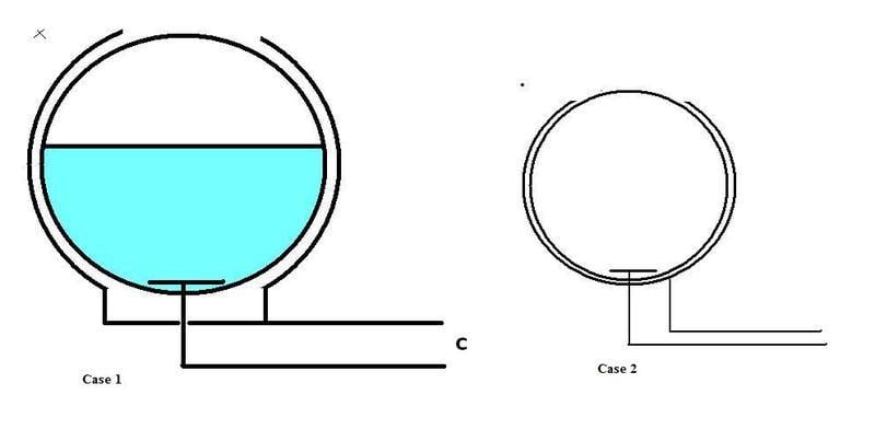

Obviously vk6kro can answer this more clearly but in essence he is talking about a two "plate" capacitor. One plate is a metal sleeve surrounding the pipe, the second is a strip of conductor that runs along on the inside of the pipe. The pipe itself will separate the two "plates" and provide a small amount of dielectric.
I was thinking of a similar idea, running a metal sleeve and then having a central rod, but that was before I realized you wanted to run the pipe horizontally, not vertically.
So in your diagram, the plates outside would be shorted together and curved to fit the exterior. The inner plate stays the same. You can connect the inner plate to ground, which as v6kro mentions, probably will set the water to ground as well since it will probably be contaminated enough to be conductive.
I don't know of a closed form for doing this configuration but you can do a numerical simulation easily enough. The main question would be how you estimate the water but giving it a slight conductivity is probably realistic.

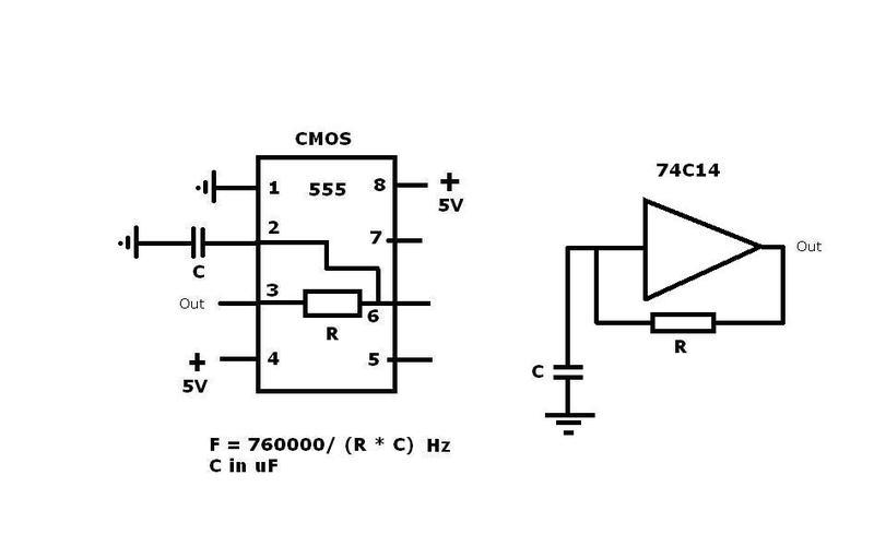

The curve would have to follow the shape of the pipe.
We are assuming the water is conductive, so it fills the pipe to some height making contact with the inside of the pipe.
Then we want just the thickness of the plastic pipe to be the dielectric. So the outer conductor has to be as close to the outside surface of the pipe as possible.
This way, the capacitance should be quite large and measuring it should be easier too.
You can get very thin copper sheet from craft stores.
You could have an oscillator like one of the following
which would generate a square wave whose frequency depended inversely on the depth of water in the pipe. These oscillators have one side of the capacitor grounded, which may be necessary in this case if the water is grounded.

In the calculation, there is 200 mm of outer copper along the pipe and assuming it encloses the pipe completely around its circumference.
The only part of the pipe which has significant capacitance is where there is water on the inside. This has an area of 200 mm along the pipe * half the circumference (157 mm).
This is to show the calculation figures. The copper plate is curved and covers the whole of the pipe for 200 mm of its length, but only the bit with water opposite it counts for this calculation. (The dark blue bit is the top of the water. The artist got carried away a bit :) )
The two copper plates got replaced by one plate on the outside of the plastic pipe which covers the entire outside surface.
Also in post #15 u showed the mounting of the plates. Is it ok that if we mount the outside plates as in figure 2( below). This would be easier to keep the plates very close to the pipe. i.e taking a cylindrical plate and cutting a small portion out from the top portion.
Yes, just like that.
Would it be useful to calibrate the readings for equal area steps rather than height? This would give you a scale that showed equal increments in water volume in the pipe.

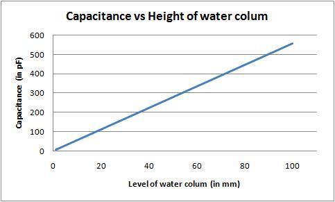

Hello guys...
I started to mount the plates and design an oscillator. I mounted a 65mm long copper plate around the pipe and connected it to + 9VDC. Then I placed a small plate of staineless steel inside the pipe in the middle and connected it to 0V. After a few minutes i connected th eplates to a LCR meter to check the capacitance( Without water inside the pipe).
The value showed as around 10pF. Then i poured a few drops of water in to the pipe and the value changed to around 25pF. ( At the moment i dont have a large container to fit in the pipe and check for the full level of water.) When some small particles like paper pieces were placed in the pipe, the value changed very negligibly. 0.X pF change.
What happend next is interesting.. The few drops in the pipe started flowing outside and some of them went in to the gap between the pipe and the outer copper plate. Suddnely the reading was out of range. The copper plate is 0.5mm thick. I treid the very maximum to fix it completely over the surface. Now i need to find a solution for it.
I am designing an astable osciliator that produces around 100kHz frequency and try the output.
I hope there will be considerable change detection.
I also calculated a therotical approch with the mehtod you mentioned. The graph was also linear ... like in the figure below.
