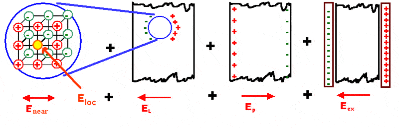

I just have a small question regarding lorentz cavity:
Refer to a small lorentz cavity in a uniformly polarised dielectric. as shown in fig.
LaTeX Code: E_{ex} : External electric field.
LaTeX Code: E_{P} : electric field in the uniformly polarised dielectric (when sphere has NOT been cut out)
LaTeX Code: E_{L} :Electric field due to surface charge on cavity
LaTeX Code: E_{near} :Field due to dipoles inside cavity.
Now, LaTeX Code: E=E_{ex}+E_{P}+E_{L}+E_{near}
But, does not LaTeX Code: E_{P} change if we cut out a sphere from the polarised dielectric?
Is it that we are neglecting the small change in LaTeX Code: E_{P} due to cut out sphere and our result is an useful approximation, but not exact?
Please, any help will be appreciated. I need to understand this for my term exam.

I'm not sure, but offhand: If you form the cavity adiabatically, then EL would compensate for the change in EP, wouldn't it? So I suspect that's the approximation involved.
