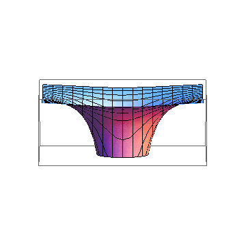

I would say the Lorentz Transformations should be applied in exact analogy to the Rotation Transformations. That is, if we have some inhomogeneity or anisotropy in spacetime, and we turn and look the other direction, then the whole thing moves, out of our sight.
What coordinates are used when I do this rotation?
Let's look for a moment at a simple example; the Schwarzschild metric:
[tex]c^2 d\tau^2 = \left( 1 - \frac{2 G M}{c^2 r} \right)c^2 dt^2 - \left( 1-\frac{2 G M}{c^2 r}\right)^{-1} dr^2 - r^2 (d\theta^2 + sin^2(\theta)d\varphi^2)[/tex]
(Thanks for the help finding the parsing error, Fredrik)
It describes a transformation from dt to dτ. And if written in its negative form, it makes a transformation from ds to a function of dr, dθ, and dφ.
My suggestion would be, instead of treating t, r, θ, and φ as "meaningless" variables, we should treat them as spherical coordinates which can easily map to Minkowski coordinates, and are in fact, the domain and range of the Lorentz Transformation equation.
Again, people will laugh at me, and say that there is no place where matter is not present, so, we have schwarzchild metric embedded in another schwarzschild metric, embedded in another schwarzschild metric. In effect, they will say there is no place in the universe where I can get rid of the curvature altogether. And therefore we might as well not try?
It's a fallacious argument. We should always be aware that there may be masses and motion that we have not accounted for, and so lines we think are straight may be curved after all. But the question is not whether we can know for certain that lines are straight. The question is whether the straight lines exist at all.
As long as we have a concept of straightness. Can we not compare one geodesic path to another geodesic path, and unambiguously declare which of those two paths is straighter? Yes, of course. The straight line is the direction that an object would travel if there were no forces acting on it at all. The geodesic is the direction that an object travels when a force is acting on it.
In real life, we know the difference. But once you start reading a lot of General Relativity books, you start calling geodesics straight lines. And for some reason, you ignore t, r, θ, and φ as "meaningless" variables, and you only look at τ, and say. The object in a geodesic only has τ changing, and is otherwise motionless (with respect to itself).
There are some great things you can do with that dτ; in particular, setting it equal to zero, to see what the path of a photon through your curved space is. But that path is through the t, r, θ, and φ coordinates. Those coordinates are not meaningless. They are the overlying GLOBAL LORENTZ FRAME COORDINATES IN SPHERICAL FORM, COMOVING WITH THE CENTRAL MASS.
If you rotate the coordinate system, r, θ, and φ are affected. If you Lorentz Transform the coordinate system, t, r, θ, and φ are affected.

No, this is wrong; in fact, again, there are at least two conceptual errors here. First, you are misusing the term "geodesic". In a curved manifold, a "geodesic" is the closest thing you can get to a straight line. There aren't any curves that are straighter. And all geodesics are equally straight, so it makes no sense to say one is straighter than another. I realize that lots of people don't like calling these curves "straight lines", because they aren't Euclidean straight lines; but that's why the term "geodesic" was invented, so we could have a name for curves in curved manifolds that are the closest analogues to Euclidean straight lines; since in a curved manifold there are *no* Euclidean straight lines at all, geodesics are the best we can do.
Try to understand that I am not drawing a line ON the curved manifold. Think of it more like drawing a line on the plane in a flat surface "above" the curved manifold. Unless you can find a situation where the curved manifold curves down under itself, there is a one-to-one mapping from the curved coordinate system to an overlying global flat coordinate system.
https://www.physicsforums.com/attachment.php?attachmentid=40656&d=1320321617
It doesn't matter if the underlying surfaces are curved, so long as none of the particles in the underlying surface go faster than the speed of light in the overlying geometry, in which case there would be causality problems.
But if I am 4 light years from Alpha Centauri, and say some black hole passed between Alpha Centauri and here. What would happen? The light from Alpha Centauri would probably be bent in every which direction, and I would know there were a problem. Let's say also, that somehow the black hole warps the space-time so that an extra light-year of rulers (physical observables) could fit between Alpha Centauri and me.
