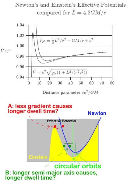

http://www.bun.kyoto-u.ac.jp/~suchii/eff.potent.html
[PLAIN]http://www.bun.kyoto-u.ac.jp/~suchii/eff.potent.jpg

I looked up the PPN expression for perihelion shift:
(2-beta+2 gamma) / 3 * 6 pi M_sun / a(1-e^2)
So some of it "just appears", i.e. it's not related to any particular PPN parameter, at least not obviously, some of it can be ascribed to gamma, the space curvature, which was the original explanation, and beta subtracts, beta being "nonlinearity in the superposition of gravity".
So I'd say the space curvature explanation is simple but not really very accurate, for one thing you'd still have some perihellion shift even if it gamma was zero. But the good news it seems to be in the right ballpark, if you look at only the gamma term it gives 2/3 the right value, which isn't bad. But clearly there are other effects that also cause perihelion shift as well as space curvature, though it's not clear what they are from the PPN expression.
I'm trying to come up with an intuitive, yet correct explanation based on the effective potential. The problem is that in the links I posted are not very clear about what "causes" the "extra dwell time" at the inner part.
I found a plot in the this old thread:
https://www.physicsforums.com/showthread.php?t=224397
And sketched two "reasons" for the "extra dwell time" below it:
What is a better explanation? A, B, both or something else?
