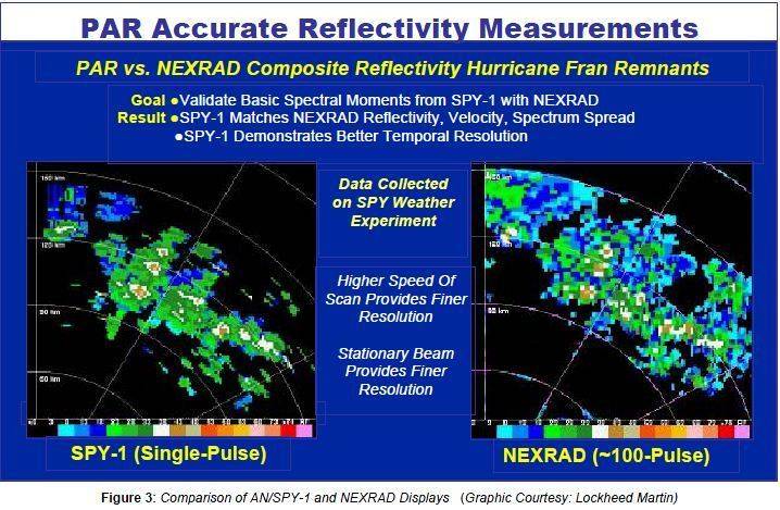

It appears progress in radar and computers might effectively accomplish the same goal as tornado prevention, at least to some degree. If you could predict with extreme accuracy and lead time when a tornado happened, this would reduce the need to prevent it (which might not be possible, anyway).
A big limitation to current tornado warnings is the slow 5 minute update cycle on the WSR-88D doppler system. This limits warning time, plus limits data needed for vortex signature analysis.
Currently tornado warnings are issued only on visual sightings or radar-indicated features combined with human analysis. There's a fairly high false detection rate. You normally want more than a single radar frame before calling a warning, which would take 10 minutes for two frames. A rapidly developing storm can slip between such slow updates.
Phase array radar (like used on Navy Aegis ships) could increase the update rate to 60 sec for a total volume coverage pattern, maybe faster. In weather reflection tests, the Navy Aegis SPY-1 radar already exceeds the temporal and angular resolution of the NexRad WSR-88D, despite the latter using 750,000 watts output. See graphic.
The National Weather Service has a single phased array weather radar test installation, called MPAR (Multi-mission Phased Array Radar). The optimum scan pattern is still being researched. Also, because the beam is electronically (not mechanically) steered, a severe storm region could be selectively painted every few seconds without sacrificing less-frequent 360 deg. coverage. This could increase the update rate for a given storm cell by a factor of 50 over the current WSR-88D system.
If MPAR is ever funded and deployed nationwide, the additional data from the high update rate could be combined with new computer models to issue high-confidence warnings much further in advance. At least that's the theory. The goal is "warn on forecast", vs the current "warn when tornado is detected".
If that happens and the lead time, accuracy and confidence level of tornado warnings greatly improve, people can just get out of the way.
