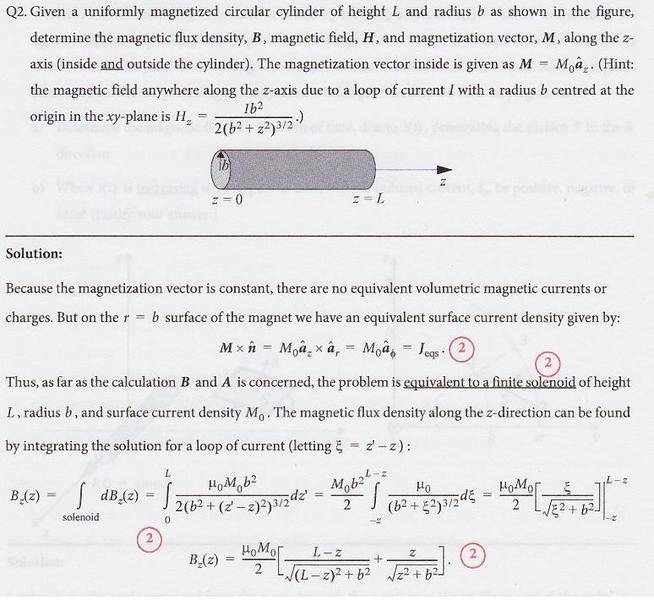

Can someone explain to me why he uses,
[tex](z' -z) \quad \text{ and } \quad dz'[/tex]
What is the meaning of the ' ?
When I did this question, I preformed the integration with the limits from 0 to L with the z in tact using a differential dz.
Is that wrong?

He's using [itex]z[/itex] to be the coordinate of the point where we want to calculate the magnetic field, and using [itex]z'[/itex] to be the coordinate of the current loop. The distance from the current loop to the point is [itex]z - z'[/itex], but he probably skipped a step and used [itex]z' - z[/itex] instead because [itex](z-z')^2 = (z' - z)^2[/itex]. To consider the effects of all the loops from coordinate [itex]0[/itex] to [itex]L[/itex], you have to integrate w.r.t. [itex]z'[/itex] from [itex]0[/itex] to [itex]L[/itex].
If you've integrated w.r.t. [itex]z[/itex] from [itex]0[/itex] to [itex]L[/itex], then you've found the magnetic field at coordinate [itex]0[/itex], but you haven't found the magnetic field at a general coordinate [itex]z[/itex].

Is there any other way you can reason this problem out without using the z'?
I'd like to see the other perspectives if there are any.
