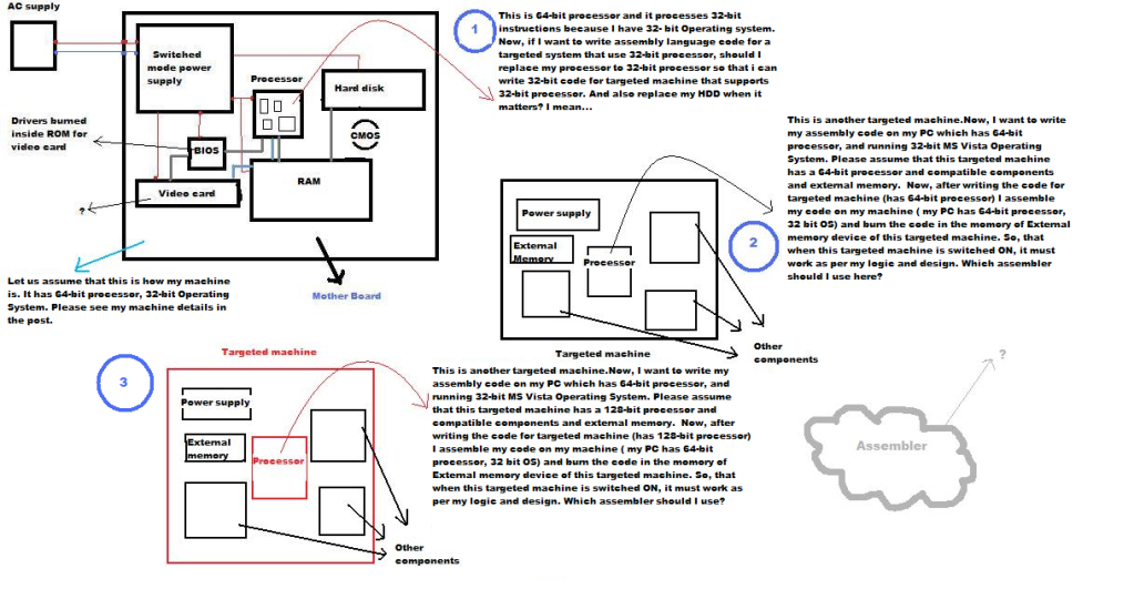

Did I understand Paul's words correctly? Please see the figure. Figure 1.

Question1:
I want to write assembly language code for 16, 32, 64, 128-bit processors on the machines that run 32-bit or 64-bit (or possibly even higher bits!) Operating system. I want to start with 16-bit, 80x86 processor architecture and later move to processors that support/accept more number of bits for processing, like 32-bit processor or 64 bit processor or 128 bit processor at once and so on. I may even change my machine on which I am going to write my code for the target machine. Currently I am using 32-bit processor, detail information about my machine is given above. Do I have to change my 32-bit processor computer machine if I want to target a processor that takes 8-bits or 32-bits or 64-bits of inputs? Which assembler should I used? Please see the figure below. Figure 2.
As I already suspected and predicted earlier that there are going to be problems for me in using and finding a good assembler. I did some reading on FASM, NASM, MASM, TASM. Each of them have their limitations. MASM only good for windows. TASM not free and maintained properly, NASM supports few things but is only good for 32-bit processors. I found FASM to be good but it does not have much parsing power.
I am not a master in programming using Assembly language but I want to work dedicatedly on this so, I want and I wish atleast one assembler to be perfect. Like say, having AASM (Awesome assembler). Do we have anything like that? I mean someone should be able to say, "just take this assembler buddy and you should be able to use it to program anything using assembly language on any processor architecture whether 16-bit, 32- bit, 64 bit, 128 bit and so on and on any bit Operating system, like 16-bit, 32-bit, 64-bit ...and 128-bit!" No, I am not picky, I just want to be able to do my work perfectly, like everyone else in the league. Please see the figure below. Figure 3.
Question 2:
Please tell me about 128-bit processors and can the number of bits supported by a processor go beyond 128-bits. Can we see 128-bit Operating system in the future? And can we create a HDD that can allocate so many(how much exactly?) memory location and give each memory location a unique address, so that I can store data into those memory locations? How will RAM that supports 128-bit of information and carry 128-bit of information to the processor and HDD going to look like? Is there a possibility to go beyond 128-bit on HDD, RAM, Processor?

phinds
#14
Jan27-12, 01:20 PM
PF Gold
phinds's Avatar
P: 6,089
Quote Quote by pairofstrings View Post
Question 2:
There is no conceptual limit to processor word size, but it will not be compelling for quite a few years to move beyond 64 bits for normal computer use.
HDD and RAM have little, if anything to do with each other. They are totally different technologies and your confusing the two / equating the two is not helping your understanding of computers.
EDIT: also, you continue to confuse O.S. size and computer word size. They are not the same. You can run a 32 bit operating system just fine on a 64-bit machine (but you can't do the reverse).
I find your colored graphics / lettering unreadable, so can't comment on any of them
