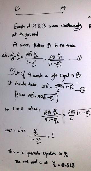

Please refer to the attached diagram
The train moves in the direction B-A
If the events seen in the ground observer simultaneously, it should be seen at A before B in the train
In special case, the difference in times between A and B according to the train observer could be equal to the time a light signal takes to travel from A to B only if v/c=0.618
However, if the light travel from A to B relative to the train observer, it should do so relative to the ground one as well. But because of the experiment setup, still the ground observer sees the 2 events happen at the same time
So what will be the events relative to the ground observer, a time-like or space like?
Thanks,,,
http://www.physicsforums.com/attachm...1&d=1330188385

seperated spatialy and can be observed as happening simultaniously, spacelike I think.

what will be the events relative to the ground observer , a time-like or space like?
If two separate events are simultaneous in a particular frame, they have a space-like separation in all frames.

Quote Quote by Michael C View Post
OK,,, but according to my calculation attached here, the Δt` between A and B for the train observer can be equal to the Δt`taken by a light signal from A to B in case of v/c=0.618. This yields a time-like separation !

In the first sentence (in the attachment), you're talking about A and B as if they are events. Later you're talking about them as if they are locations in space (specifically in the slice of spacetime that the ground considers space). This makes your argument quite confusing.
If A and B are events, it only makes sense to say that a light signal is sent from A to B if their separation is lightlike, but this would of course immediately contradict the earlier claim that there's an inertial frame in which A and B are simultaneous. Then you start talking about calculating the time it takes the signal to go from A to B. By then you are clearly thinking of A and B as locations, not events. The signal would be sent from an event E on A's world line and received at an event F on B's world line. The separation between E and F is obviously lightlike.

Quote Quote by Fredrik View Post
I meant A and B as events
If A and B are simultaneous for the ground observer, they must have a spacelike separation for the train observer. This should not permit Δt` to be long enough to allow B receiving any light from A. But that may happen if v/c=0.618 !

Quote Quote by Adel Makram View Post
Then your calculation doesn't make much sense. You wrote "AB", meaning "the distance in space between A and B in the ground's(?) rest frame". That's OK, since A and B are by assumption simultaneous in that frame. But then you multiplied AB by ##1/\gamma##, expecting to get the distance in space between A and B in the other frame. The concept of distance in space in the train's frame between A and B doesn't make sense, since A and B aren't simultaneous in that frame. What you're calculating this way is the distance in the train's frame between the two points on the ground where A and B occurred. This is not a distance between A and B. It's the distance in the train's frame between A and and an event C on the world line of the point on the ground where B occurred. C would occur significantly later than B, but still not late enough to receive a light signal from A.
The distance AB` for the train observer won`t change because he sees the event A happens before B. He always considered A and B simultaneous whenever he measures AB` as a distance.
The derivation of Δt` according to LT is also based on that assumption and therefore multiplying AB by ##1/\gamma## to yield AB`. So multiplication by ##1/\gamma## occurs on both sides of the equations i & ii and it will cancel each other out
And even if you don`t want to consider ##1/\gamma##, no problem, as the quadratic equation still remains valid because AB` will cancel each other out again
I don't understand what you're saying here.
##(AB)/\gamma## isn't the distance between A and B in the train's frame. There's no such thing as a distance between A and B in the train's frame, because A and B are not simultaneous in that frame. ##(AB)/\gamma## is the distance in the train's frame between the points on the ground where events A and B occurred. It's a distance in spacetime along a simultaneity line of the train's frame. There's such a simultaneity line through A, and another one through B, but there's no such simultaneity line through both. So ##(AB)/\gamma## is definitely not the distance in the train's frame between A and B.
I think you need to think about what you're actually calculating using the length contraction formula. You can't plug in the distance between two events and expect to get the distance between those same events in another coordinate system. That's not just wrong, it doesn't make sense. Think about it this way instead: In a spacetime diagram where the axes are the t and x axes of the ground's frame, the world lines of the two points on the ground are vertical lines. A and B are two points on those two lines. Since they are simultaneous, there's a horizontal line that goes through both of them. The length of that line segment from B to A is what you called AB. But ##(AB)/\gamma## is the length that an observer on the train would assign to a line with slope 1/v between two events where such a line intersects the two vertical lines.
"Won't change" relative to what? The distance between the places where A and B happen will certainly be different when measured in different frames.
If you assign coordinates to the events A and B in the ground frame, you can use the Lorentz transformation to work out the coordinates in the train frame:
THE GROUND FRAME:
Let's say that the distance between the two events in the ground frame is d. To make things easy, we'll put event A at the origin:
Event A: t = 0, x = 0
Event B: t = 0, x = d.
THE TRAIN FRAME:
We define the train frame to have the same origin as the ground frame. It is moving relative to the ground frame along the x axis at a velocity of v. The Lorentz transformation gives us the coordinates of the two events in this frame:
Event A: t' = 0, x' = 0
Event B: t' = -[itex]\gamma[/itex]vd/c[itex]^{2}[/itex], x' = [itex]\gamma[/itex]d.
Increasing the velocity difference between the two frames will not only increase the time separation between A and B, it will also increase the spatial separation: you can see from the coordinates that the distance in space between the two events has been multiplied by [itex]\gamma[/itex]. The space-time interval between A and B stays the same.
