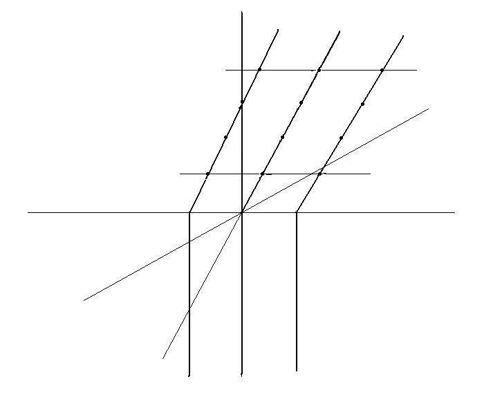

Apr4-12, 02:42 PM   #81
Please, look at this
Quote by DaleSpam View Post
As per the OP, the clocks are initially synchronized in R's frame such that at t=0 they all read 0. So, we can calculate the time displayed on each clock, τ, using the spacetime interval. Solving for t we get:
[tex]t=\begin{cases}
\tau & \mbox{if } \tau \lt 0 \\
1.25 \tau & \mbox{if } \tau \ge 0
\end{cases}[/tex]
You have defined here [itex]\tau[/itex] is time reading of train's clocks for R.
Suppose, there is only one clock in train. When train is at station the R, O and the clock have same space component in platform co-ordinate system. Now at t=0 train's speed is 0.6c. So we can draw the world line of the clock like this.
Click image for larger version
We can easily see that when 1.25 reading in R's clock for R, O's clock reading is 1 for R. And when 1.25 reading in O's clock for O, R's clock reading is 1 for O. So moving O's clock slow down with respect to R, and moving R's clock slow down with respect to O. Here you have used simple transformation formula [itex]t = \gamma \tau[/itex], because space component is 0 at initial stage. We get one value for [itex]t[/itex] for [itex]\tau = 1[/itex] and [itex]x = 0[/itex].
Now, if we put another two clocks at train's front and train's end. And you have said that the the clocks would be dilated for R at same rate and would remain synchronized for R. So, as per your saying, the world lines of the three clocks would look like this.
You can see that lines of simultaneity of R's frame says that clocks is dilated with same rate and clocks is synchronized.
But, do you notice what is wrong with this diagram?
We cannot use the [itex]t = \gamma \tau[/itex] formula to calculate readings of front clock and end clock. Because, now the space component is not same for R, front clock and end clock. We have to consider space component in calculation. Here space component is not 0 of the new two clocks at initial stage. Another thing is you can see in above diagram that difference between space component doesn't change after frame changing. But, if we transform some (t, x)=(0, x) point to another co-ordinate system we will get (t', x')=(0, x'), where x ≠ x' surely. So after transformation space component of clock should be changed.
So, we have to use this equation [itex]t = \gamma (\tau - 0.6x)[/itex]. We get three values for [itex]t[/itex] by putting ([itex]\tau = 1[/itex], [itex]x=-1[/itex]), ([itex]\tau = 1[/itex], [itex]x=0[/itex]) and ([itex]\tau = 1[/itex], [itex]x=1[/itex]) in equation. So R will see [itex]\tau = 1[/itex] at different different time in his frame. The above space component problem will also be solved with this equation. This scenario can be described by below image.
We can easily see that lines of simultaneity of O's frame says that train's clocks is synchronized for O, but not for R. So, train's clocks would not be synchronized for R.
First, when you are doing spacetime diagrams what you are doing is mapping the position of an object as a function of time to the shape of a geometric object. This increases the dimensionality of an object, i.e. a 0D point particle is represented by a 1D worldline (for this analysis we are ignoring the size of the clocks so they are represented by worldlines).
Second, you can always write a 1D worldline in parametric form with a single parameter. So, you can always write it in the form [itex](t(\lambda),x(\lambda),y(\lambda),z(\lambda))[/itex] where [itex]\lambda[/itex] is the parameter.
http://en.wikipedia.org/wiki/Parametric_equation
Third, the parameterization is not unique. So if you have any continuous and invertible function [itex]\lambda(\zeta)[/itex] then [itex](t(\zeta),x(\zeta),y(\zeta),z(\zeta))[/itex] is also a valid parameterization of the same worldline.
Fourth, the parameter need not have any significance, but it can. For example, one common parameterization is to use the time in a given reference frame, t, another common parameterization is to use the proper time displayed on the clock, τ.
I follow this.
The latter parameterization is particularly common since it is frame-invariant and physically measurable.
I don't follow this.
Fifth, if you have multiple worldlines then each worldline will have its own parameterization and thus its own parameter.
Sixth, for each reference frame there are a series of surfaces of constant coordinate time called hyperplanes of simultaneity, or just planes of simultaneity. There is one such plane for each value of coordinate time.
Seventh, two clocks are considered to be synchronized in a specified reference frame at a given coordinate time iff their displayed proper time is the same at their respective intersections with the plane of simultaneity.
I follow this.
I will try to post the application of these principles to this specific problem later today.
Certainly.
Apr4-12, 04:11 PM   #83
Mentor
Quote by mananvpanchal View Post
The proper time is a frame invariant quantity, meaning that all reference frames agree on what it is. It is the integral of the spacetime interval along the clock's worldline. The proper time is also measurable, specifically, the reading that a clock displays is the measurement of proper time. At any event along the worldline all reference frames must agree on what the clock actually reads.
Apr4-12, 04:31 PM   #84
Mentor
OK, so to use the above approach in this problem the first thing that I did was to write the worldline of the clocks in parametric form. Since you first described the situation in R's frame, I used that frame for the description and parameterized it in terms of coordinate time. The result is the first equation of post 42.
Then, since the parameterization is not unique and since proper time has the advantages listed above as well as the direct application for determining synchronization, I decided to re-parameterize in terms of proper time instead of coordinate time. The relationship between the two parameters is the second equation in post 42, and the resulting parametric equation of the worldline is given in the third equation.
Once that is done, then the worldline in the primed frame is found simply by using the Lorentz transform, as shown in post 48.
Now, we have a parameterization for each worldline in terms of proper time in both the primed and the unprimed frame. So at this point we make 3 worldlines, corresponding to A, O, and B, by substituting d=-1,0,1 respectively. As mentioned above, each worldline has its own parameter, hence the subscripts on the proper time. I.e. there are three clocks displaying numbers and so there are three proper time values listed.
Now, in order to determine if a pair of clocks are synchronized in some frame we find the proper time at the intersection of the worldline of each clock with the same plane of simultaneity. This is done by setting t or t' equal to some value and solving for the two values of proper time. If the values are equal then the pair of clocks is synchronized and vice versa.
Does that make sense now?
Apr4-12, 04:50 PM   #85
Mentor
Yes, we can. The proper time displayed on the clock is given by the spacetime interval between the event on the worldline where t=0 and any other event on the worldline.
[itex]\Delta\tau^2 = \Delta t^2 - \Delta x^2 - \Delta y^2 - \Delta z^2[/itex]
For τ>0
[itex](\tau - 0)^2 = (t-0)^2 - ((0.6t+d) - (0 + d))^2[/itex]
[itex]\tau^2 = 0.64 t^2[/itex]
[itex]\tau = 0.8 t[/itex]
The d cancels out.
