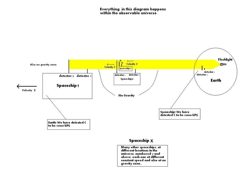

OK. Please look at the attached diagram. Will any spaceship from the group 'spaceship x', observe any change in light speed, before or after light enters detectors d1 and d2, located on spaceship3?

The three common "event horizons" to appear are those for black holes, the one for the observable universe, and the Rindler's horizon for accelerating observers.
None of these can really be fully dealt with using only special relativity. In the Rindler's case, one can do some of the analysis using only SR. One can, for example, deduce that constantly accelerated observers travel on hyperbolas.
All local measurements of the speed of light will result in c. This is true also in general relativity.
But since whosapopstar clarified his original question with more information from post #3 saying he meant a Frame of Reference moving at a constant speed (with respect to another FoR), I gave my answer in post #4 from the context of Special Relativity. In SR, the Lorentz Transform can handle any event. It's important for whosapopstar to understand the different ways his question can be interpreted. In the context of SR and LT the answer to his original question is no. In other contexts, such as General Relativity, the answer could be yes, but then, I don't know why he brought up the issue of constant speed.
I thought we resolved your questions with regard to your diagram in posts 10 through 15 of Why is light speed constant in all reference frames?

Yes,
Did connect again with the explanation, and now, might know what kind of questions popped up in my mind afterwards, which boiled some months later to what i actually want to ask today:
1. What about, 'slow transport'? Which means as much as I understand, that each detector has already a clock, that was synchronized at one point, and then they where moved very slowly to their places at detector 1 and 2.
2. Is the reason that i can see a laser, when standing at point C, while the laser is actually pointed from point A to B, is that there is refraction with the air and smoke etc...or does it also occur in space? e.g. that i can observe the laser 'from the side'? (Space e.g. no gravity, no air etc...)

Einstein was well aware of slow transport of clocks and he rejected it in favor of his prescribed convention for establishing Coordinate Time. A clock keeps Proper Time. What we want is Coordinate Time. Once we adopt Einstein's theory of Special Relativity, we can see that the slow transport of clocks does not result in the same time on them as what we need for Coordinate Time except in a particular rest frame. In other frames, the slow transport of clocks does not correspond with the Coordinate Time.
Yes, the laser beam illuminates particulate matter floating around in the air which scatters the light so that you can see it. In a vacuum, either in space or in a vacuum chamber on earth, you won't be able to see the beam. When the astronauts were walking on the moon, the sky was black. The could not see any sunbeams or effects from their silhouettes casting shadows.
